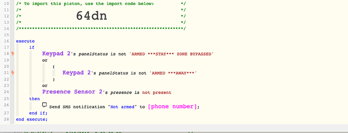

Hello,
I’m trying to switch the wording for the last IF “or Presence Sensor 2’s…” to an AND instead of the OR. In other words, I’d like it to be IF “Keypad 2’s…” OR “Keypad 2’s” AND “Presence Sensor 2’s…”
How would I change the last OR to an AND?

Move that first keypad 2 into the group that has the second keypad2 in it and use OR, then simply change the OR to an AND That is between the group of keypads and the presence sensor.
IF
Keypad 2 blah blah
Or
Keypad 2 blah blah
AND
Presence sensor blah blah
Thanks, I was able to drag on the left side and get it to reconfigure - took a bit of messing with.
