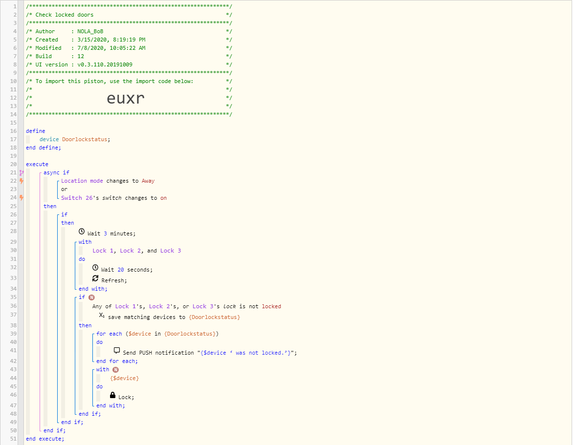

I have a piston that is supposed to check if my doors are locked. It keeps notifying us that they are not locked, yet they are. Does anyone have any ideas?

Let’s see what we have here:
2:09:51 AM = [Switch26].switch = on (Requesting a wake up for 2:12:51 AM (in 180s))
2:09:56 AM = [Switch26].switch = off (nothing happened, as expected)
2:12:52 AM = [Home].time (nothing happened, Requesting a wake up for 2:13:12 AM (in 20s))
2:13:12 AM = [Home].time (a split sec after the Refresh, Lock 1 & Lock 3 was seen as not locked)
I think the main thing is, you’ll want to move the 20 sec wait after the Refresh command.
(this (hopefully) allows for enough time for the slow locks to update)
Side Note:
I am very surprised that this logic has not given you any problem:
pic
(how can an empty IF be true?)
That is interesting. If trace was turned on it would be interesting to see which evaluation group that was. The empty if must always evaluate true somehow.
Thanks! i didn’t see that. I cleaned it up and re-arranged the refresh. The problem is my door locks, but the device never says locked…grr August locks!
Unfortunately, this is common with most brands of locks…
(I suspect it is due to the safety checks in place)
For example, if the lock pushes in 99% of the way, the DH will often say it is unlocked, since technically, it has not fully seated itself.
Personally, if I had to choose between which false alarm is best, I would rather be told:
  • Door is unlocked (when it isn’t)… instead of:
  • Door is locked (when it isn’t)
From a safety standpoint, it makes sense for door locks to error on the side of caution…
(although I suspect their motivation was to prevent litigation)
