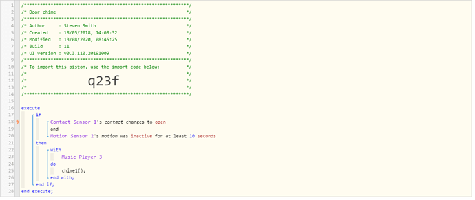

I am giving this a go, as logically it appears it would do as I wanted.
This is what I had before, but it isn’t working:
