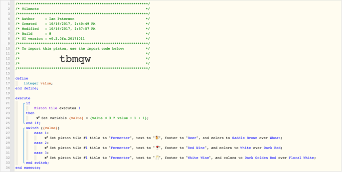

How about a single tile in the webCoRE dashboard that toggles when you tap it? You can adapt this example to work with a global variable rather than the local value:

I like the picture change on tile bumps! Sold on the idea there but it is only available though the dashboard. I would like to toggle from AT or my cell phone. PITA to do this from a browser while in the brewing closet.
AT is action tiles correct? You can trigger pistons to run from that if I am not mistaken. So you really just need to setup the same logic as above but instead of from clicking the tile it can just be based on when it was executed. And if it is action tiles then isn’t that browser based as well?
