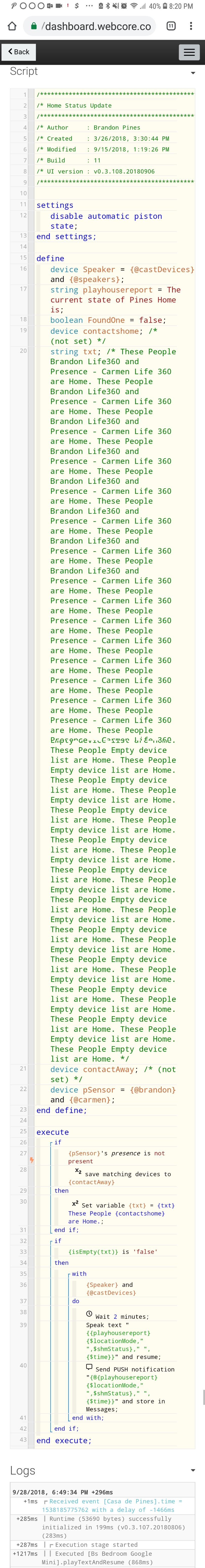

List isn’t clearing
Not have old lists
My screenshot is too long lol

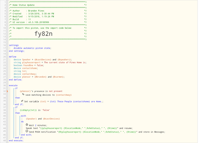

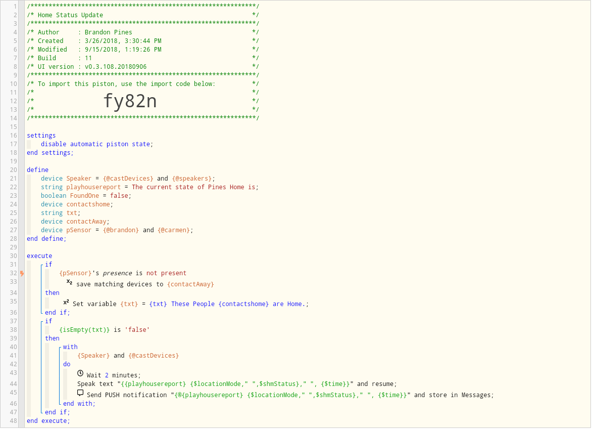

It all falls back on this line towards the top:

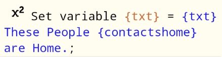

You are basing telling webCoRE to take the new data, and append it to the old variable.
Remove the blue {txt} and it will automatically fix itself the next time it runs.
