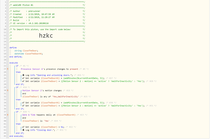

I have a piston that open the garage door when i arrive. I have a motion sensor in the garage as well. I want the door to close after three minutes after there is no motion. I only want the door to automatically close when this piston is what opened the door. The auto close with no motion is my problem. I also want to to auto close even if there was no motion. For example, I ended up not going in the garage afterall.
I guess what I really need is a 3 minute Garage door countdown timer that starts over every time motion is detected?
Open the door, close the door after 3 minutes, unless there is motion in the garage.
Right now, one of two things. The door opens and then closes right away or sometimes does not even open. pretty sure its my choice of stays inactive for the trigger.
