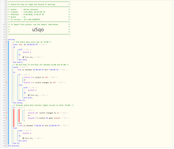

Between 7 am and noon, when Wallmote button 4 is pushed or the kitchen lights are turned on, the alarm system should disarm.
Alarm is not disarming. When these Things are actually turned on in ST app, alarm will arm when Arm Stay selected, and disarm when Disarm selected.

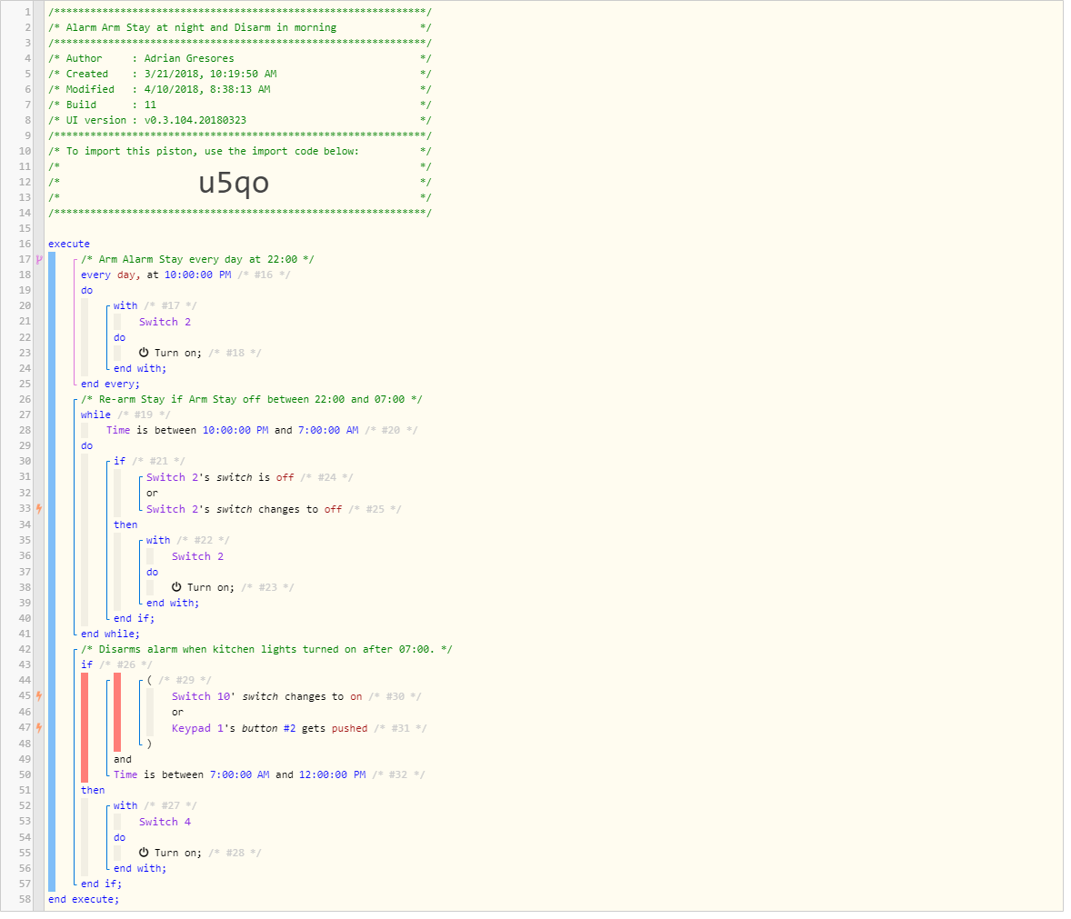

4/12/2018, 7:15:48 AM +228ms
+1ms ╔Received event [WallMote].button = pushed with a delay of 970ms
+138ms ║RunTime Analysis CS > 21ms > PS > 43ms > PE > 75ms > CE
+141ms ║Runtime (41721 bytes) successfully initialized in 43ms (v0.3.104.20180323) (138ms)
+141ms ║╔Execution stage started
+154ms ║║Comparison (time) 26148376 is_between (time) 79200000 … (time) 25200000 = false (5ms)
+156ms ║║Condition #20 evaluated false (8ms)
+156ms ║║Condition group #19 evaluated false (state did not change) (9ms)
+165ms ║║Condition #30 evaluated false (6ms)
+169ms ║║Comparison (enum) pushed gets (string) pushed = true (0ms)
+170ms ║║Cancelling condition #31’s schedules…
+170ms ║║Condition #31 evaluated true (4ms)
+171ms ║║Cancelling condition #29’s schedules…
+172ms ║║Condition group #29 evaluated true (state changed) (13ms)
+179ms ║║Comparison (time) 26148400 is_between (time) 25200000 … (time) 43200000 = true (5ms)
+180ms ║║Time restriction check passed
+181ms ║║Cancelling condition #32’s schedules…
+182ms ║║Condition #32 evaluated true (9ms)
+182ms ║║Cancelling condition #26’s schedules…
+183ms ║║Condition group #26 evaluated true (state changed) (25ms)
+185ms ║║Cancelling statement #27’s schedules…
+2039ms ║║Executed physical command [Disarm].on() (1852ms)
+2040ms ║║Executed [Disarm].on (1852ms)
+2042ms ║╚Execution stage complete. (1901ms)
+2044ms ║Setting up scheduled job for Thu, Apr 12 2018 @ 10:00:00 PM CDT (in 53049.729s)
+2053ms ╚Event processed successfully (2053ms)
