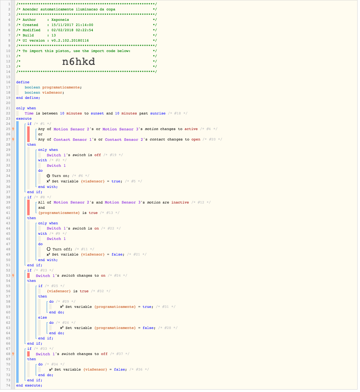

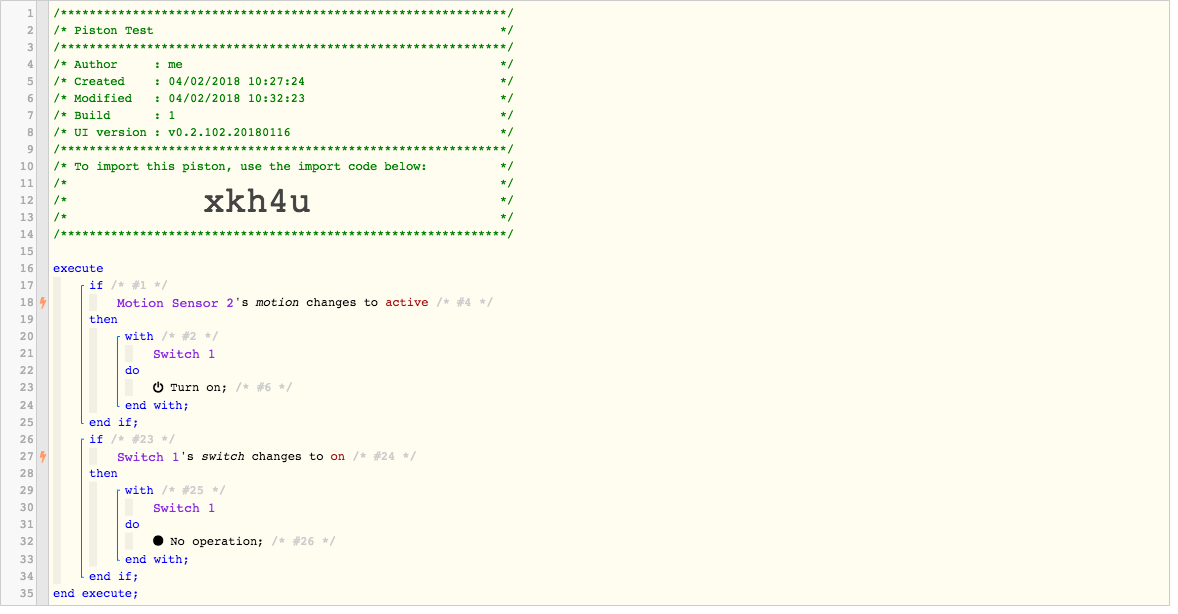

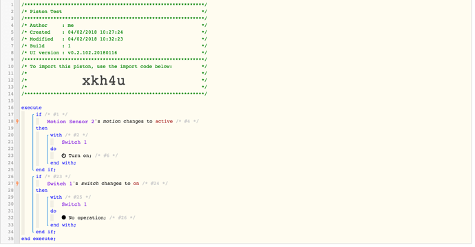

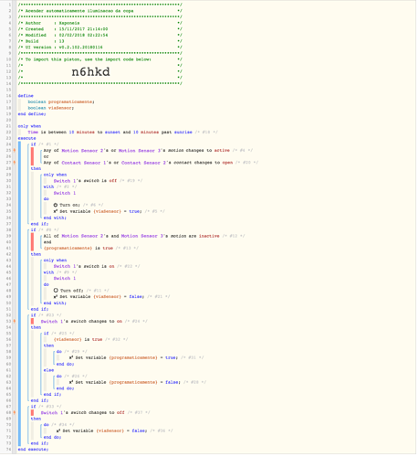

Lights are not turning off because “Comparison (enum) on changes_to (string) on = false”
Comparison (enum) on changes_to (string) on = true
- Motion Sensor Cozinha is activated
- Balcao Switch is Turn On
- Then the is statement “Balcao’s switch changes to on” should evaluate to true
**5) Attach any logs
