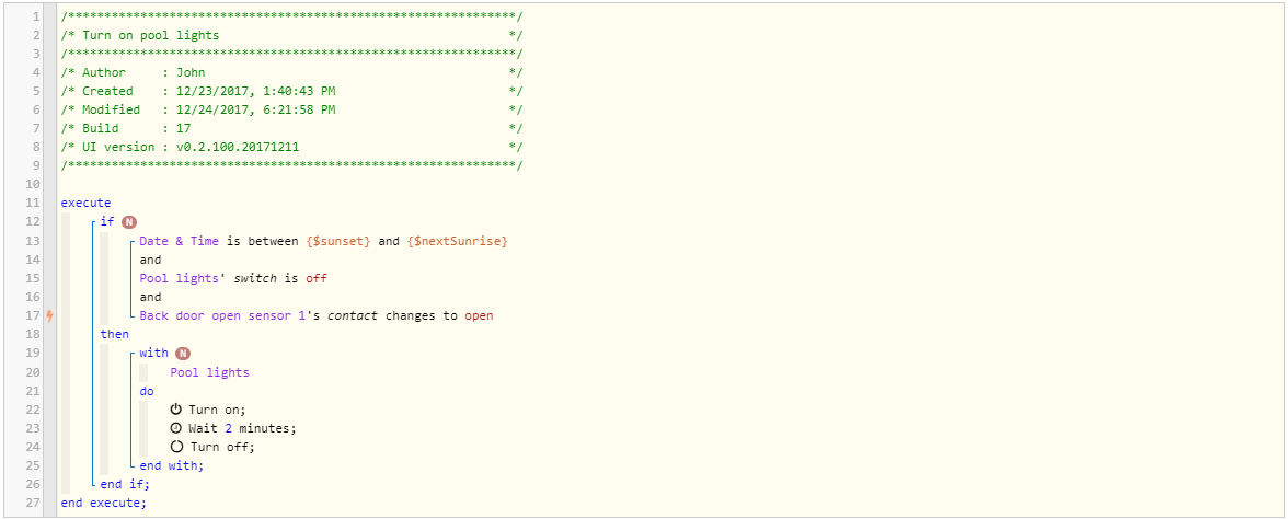

I have a rule with a condition that an open/close sensor change to open. However, the log shows that the comparison is false, even though a logical reading shows it should be true.
The then statement would execute.
The then statement is not executing because the statement: “Comparison (enum) open changes_to (string) open = false (1ms)” should be true.
If you look at the logs, at 10:37:34 the contact turns to open. And yet, Condition #9 evaluates to false. How can this be?

12/25/2017, 10:47:34 PM +440ms
+2ms ╔Received event [Back door open sensor 1].contact = open with a delay of 100ms**
+177ms ║RunTime Analysis CS > 20ms > PS > 75ms > PE > 82ms > CE**
+179ms ║Runtime (37632 bytes) successfully initialized in 75ms (v0.2.100.20171211) (177ms)**
+180ms ║╔Execution stage started**
+222ms ║║Comparison (datetime) 1514260054626 is_between (datetime) 1514241240000 … (datetime) 1514292060000 = true (4ms)**
+223ms ║║Time restriction check passed**
+225ms ║║Condition #3 evaluated true (38ms)**
+233ms ║║Comparison (enum) off is (string) off = true (2ms)**
+235ms ║║Cancelling condition #8’s schedules…**
+236ms ║║Condition #8 evaluated true (10ms)**
+240ms ║║Comparison (enum) open changes_to (string) open = false (1ms)**
+241ms ║║Cancelling condition #9’s schedules…**
+242ms ║║Condition #9 evaluated false (6ms)**
+243ms ║║Condition group #1 evaluated false (state did not change) (57ms)**
+246ms ║╚Execution stage complete. (66ms)**
+247ms ╚Event processed successfully (247ms)**

12/25/2017, 10:44:22 PM +299ms
+2ms ╔Received event [Back door open sensor 1].contact = open with a delay of 109ms
+163ms ║RunTime Analysis CS > 33ms > PS > 49ms > PE > 80ms > CE
+165ms ║Runtime (37635 bytes) successfully initialized in 49ms (v0.2.100.20171211) (162ms)
+166ms ║╔Execution stage started
+208ms ║║Comparison (datetime) 1514259862472 is_between (datetime) 1514241240000 … (datetime) 1514292060000 = true (3ms)
+210ms ║║Time restriction check passed
+211ms ║║Condition #3 evaluated true (39ms)
+220ms ║║Comparison (enum) off is (string) off = true (2ms)
+221ms ║║Condition #8 evaluated true (9ms)
+226ms ║║Comparison (enum) open changes_to (string) open = true (0ms)
+227ms ║║Cancelling condition #9’s schedules…
+228ms ║║Condition #9 evaluated true (6ms)
+229ms ║║Cancelling condition #1’s schedules…
+230ms ║║Condition group #1 evaluated true (state changed) (58ms)
+233ms ║║Cancelling statement #4’s schedules…
+345ms ║║Executed physical command [null].on() (109ms)
+346ms ║║Executed [Pool lights].on (111ms)
+350ms ║║Executed virtual command [Pool lights].wait (0ms)
+351ms ║║Requesting a wake up for Mon, Dec 25 2017 @ 10:46:22 PM EST (in 120.0s)
+356ms ║╚Execution stage complete. (190ms)
+357ms ║Setting up scheduled job for Mon, Dec 25 2017 @ 10:46:22 PM EST (in 119.994s)
+364ms ╚Event processed successfully (364ms)
