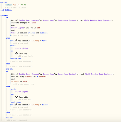

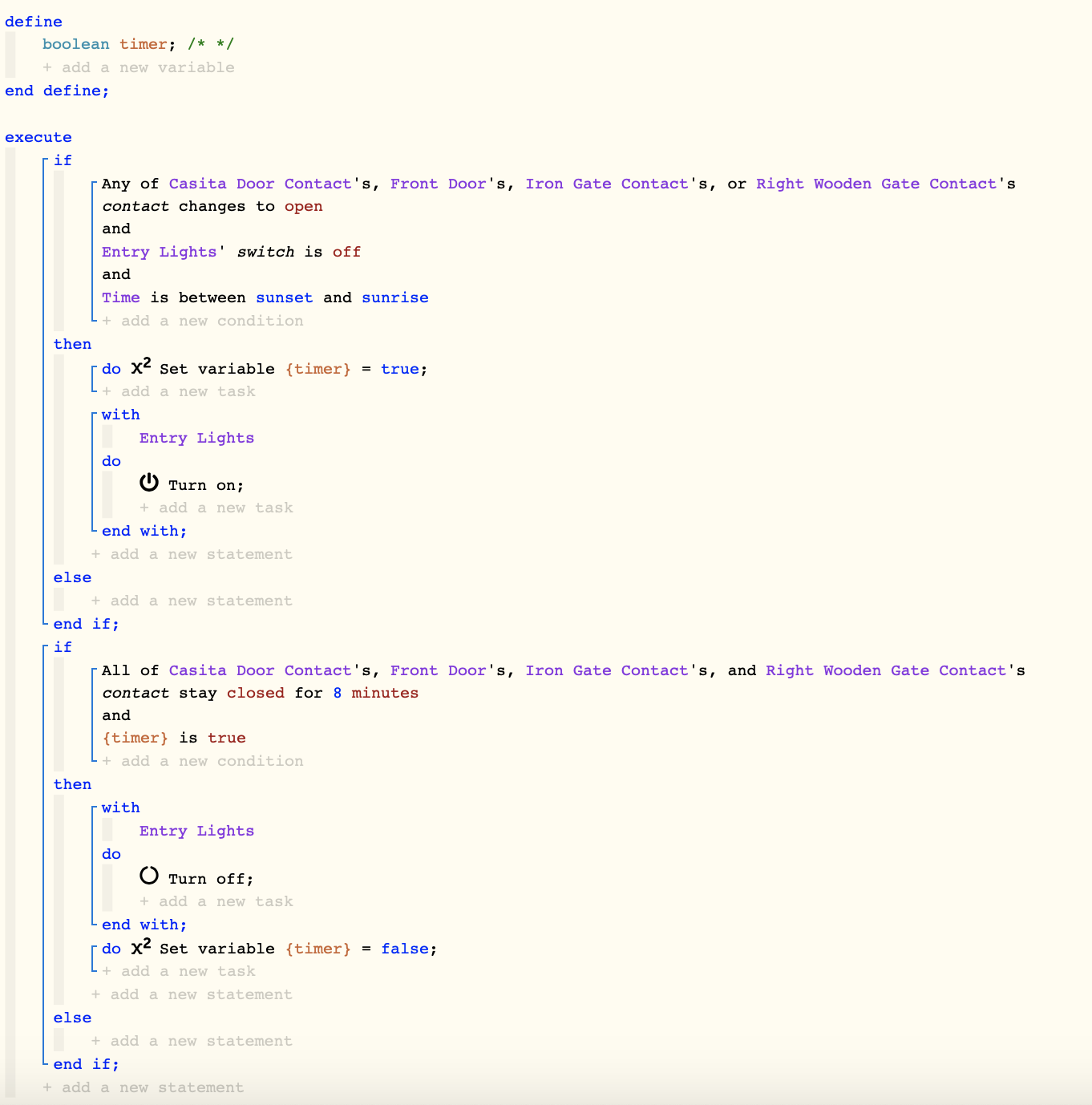

In that case, I would use a variable… This slightly modified version should do the trick:
define
    boolean timer
end define
IF
    Any of Front Door, Gate, Garage CHANGES TO open  <-- Trigger
    AND
    Entry Light Switch is Off                        <-- Condition
    AND
    Time is between sunset and sunrise               <-- Condition
    Set variable timer = true
    Using Entry Lights -> Turn On
END IF
IF
    All of Front Door, Gate, Garage's contact stays closed for 8 min  <-- Trigger
    AND
    variable manual = true                                            <-- Condition
    Using Entry Lights -> Turn Off
    Set variable timer = false
END IF
Thanks! Just set it up. Will try it out tonight!
