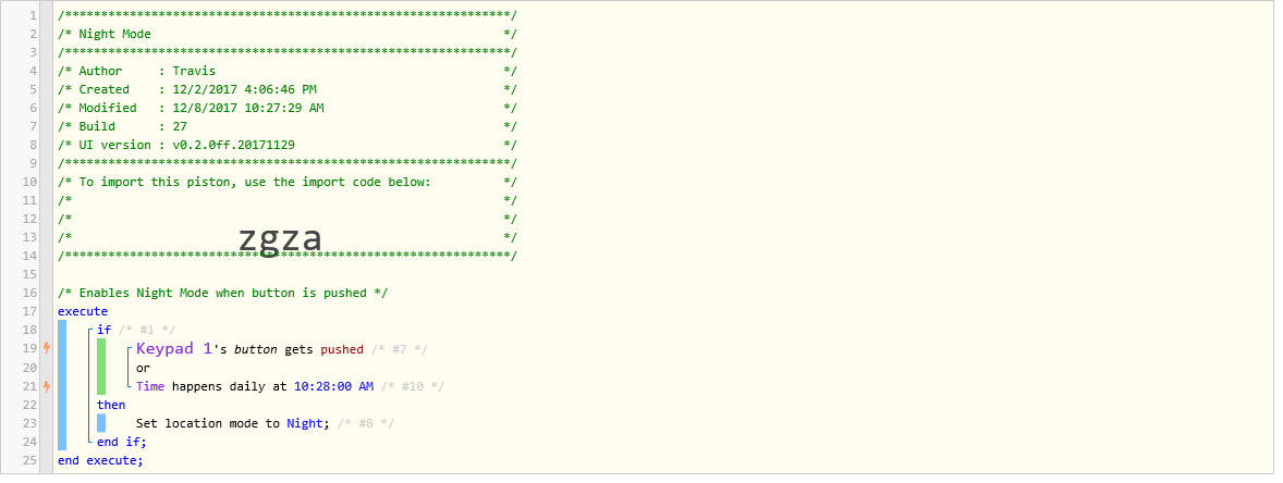

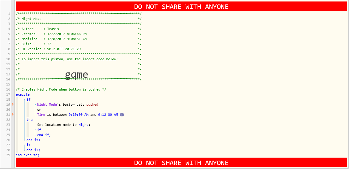

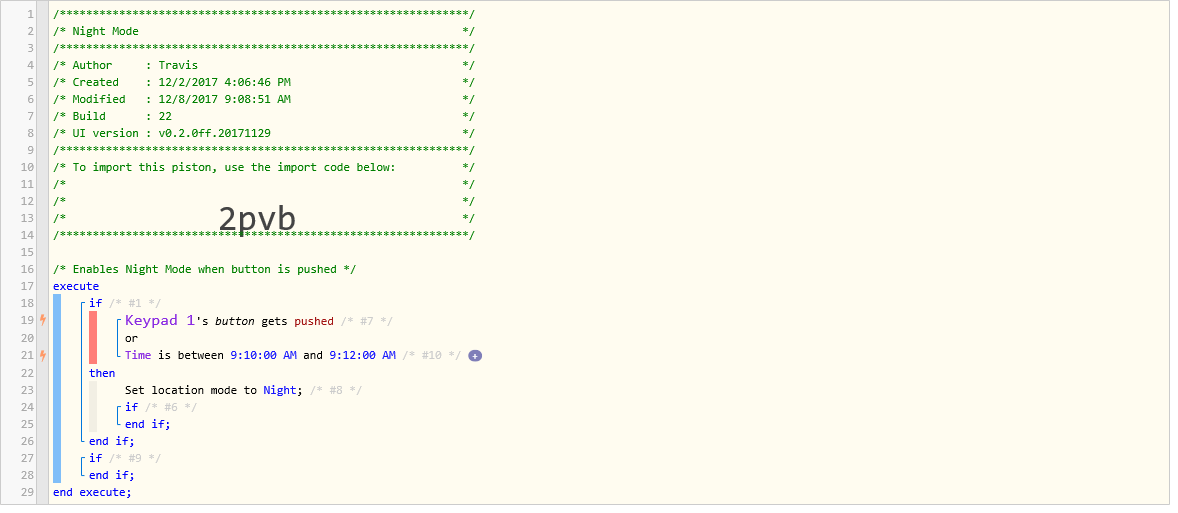

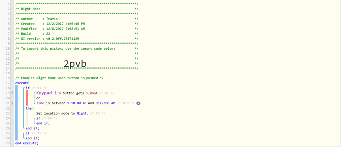

Mode change is not happening. I know this must have something to do with button being pushed as a trigger and the time as a condition but I thought I could get around that by changing the time condition to ALWAYS subscribed but apparently I’m still missing something in the trigger vs condition.
Change mode to night
Nothing happening

╔Received event [Home].time = 1512745800000 with a delay of -698ms
+103ms
║RunTime Analysis CS > 36ms > PS > 43ms > PE > 25ms > CE
+161ms
║Runtime (37994 bytes) successfully initialized in 43ms (v0.2.0ff.20171129) (159ms)
+162ms
║╔Execution stage started
+180ms
║║Condition #7 evaluated false (9ms)
+193ms
║║Comparison (time) 32999484 is_between (time) 33000000 … (time) 33120000 = true (9ms)
+195ms
║║Time restriction check passed
+197ms
║║Cancelling condition #10’s schedules…
+197ms
║║Condition #10 evaluated true (16ms)
+199ms
║║Cancelling statement #10’s schedules…
+205ms
║║Requesting time schedule wake up at Fri, Dec 8 2017 @ 9:12:00 AM CST
+207ms
║║Cancelling condition #1’s schedules…
+208ms
║║Condition group #1 evaluated true (state changed) (37ms)
+211ms
║║Cancelling statement #4’s schedules…
+290ms
║║Executed virtual command setLocationMode (75ms)
+294ms
║║Condition group #6 evaluated true (state did not change) (1ms)
+298ms
║║Condition group #9 evaluated true (state did not change) (1ms)
+301ms
║╚Execution stage complete. (139ms)
+303ms
║Setting up scheduled job for Fri, Dec 8 2017 @ 9:12:00 AM CST (in 120.395s)
+322ms
╚Event processed successfully (321ms))`
