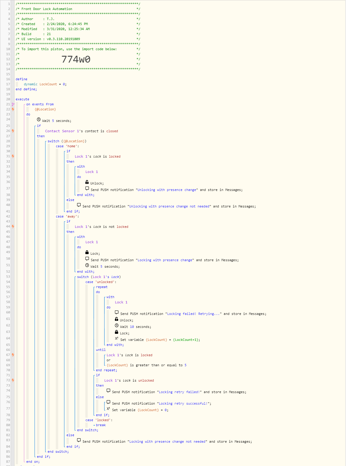

EDIT: Here’s what I have. No idea if it works or not yet.

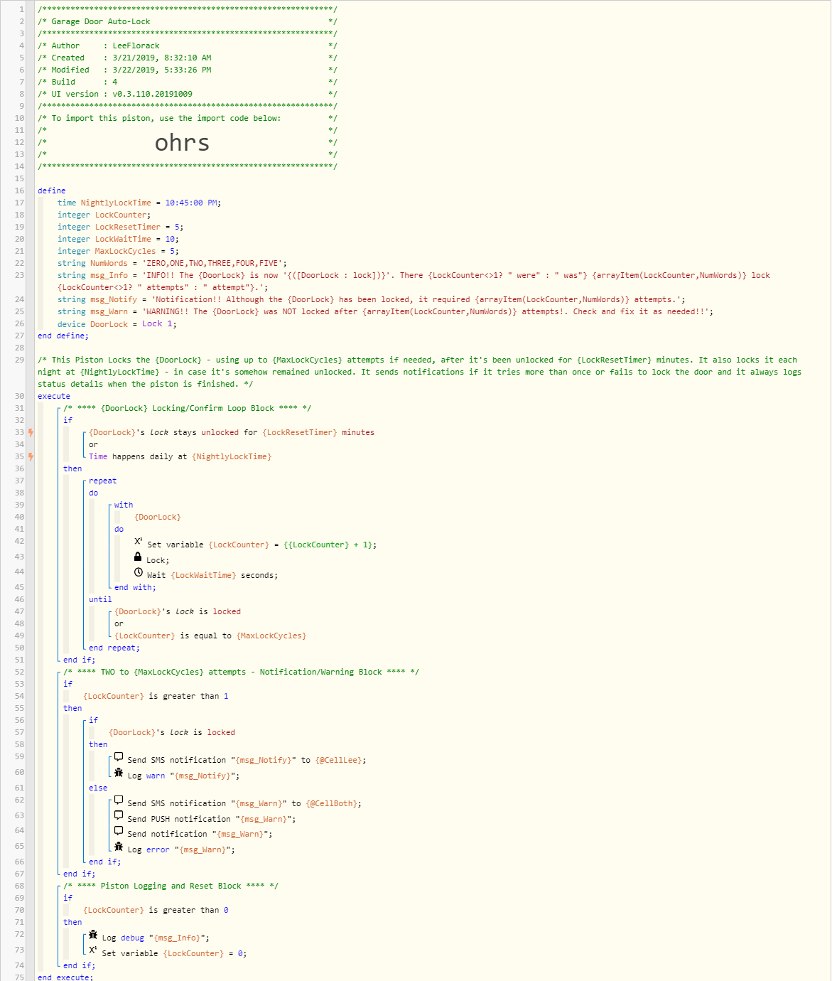

Here’s what I use:
Essentially, this piston fires after (5) minutes of the door being unlocked OR nightly, prior to going to bed for security insurance. For the specific loop question you asked… I use a Repeat Loop - with an ‘until’ condition check. It loops until successful (door is locked) OR until it makes (5) attempts - as set by a ‘MaxLockCycles’ variable. The setting of a maximum number of attempts prevents the piston of looping ‘forever’ under unusual circumstances. The ‘LockCounter’ variable counts the attempted number of cycles. After each completed run, it logs successes and if it requires more than one attempt, it sends SMS notifications to me. If unsuccessful after (5) attempts, it sends out ST notifications to both my wife’s and my phone as well.
I use similar logic for setting thermostat heat and cool setpoints.
I’ve used a While loop in my pistons, but otherwise, mine is the same as yours. I also do the same for shutting things off. In my house, I find that about 5-10% of the time, some switches need 2 or 3 attempts before they finally turn on or off.
One suggestion: When the piston starts executing, you should set your loop counter to 0 (but not in the Define area). I’m not sure the value that it will have when you repeatedly execute this piston.

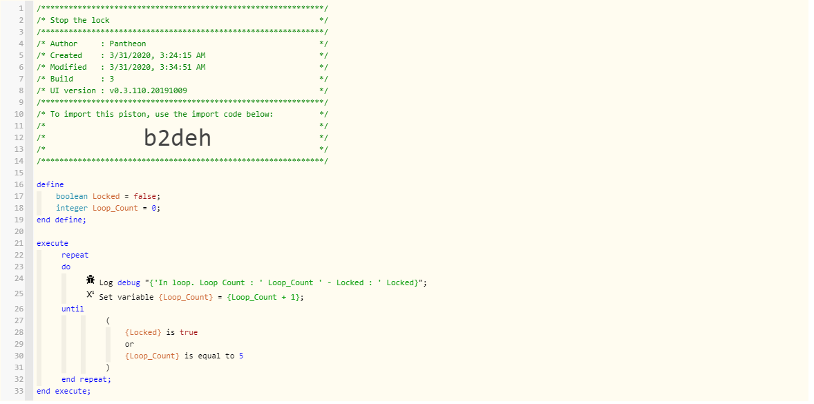

you can use the ‘break’ command to exit the loop. you have to test some condition/variable, then if true
‘break’
Break is part of "advance statements’
