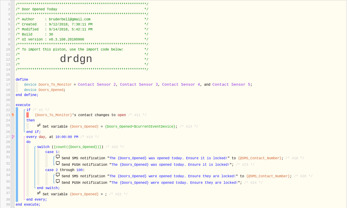

I’ve got a couple kids who are good at unlocking doors and not locking them, so I’m working on this piston to notify me which doors have been used during the day.
When a monitored door’s contact opens, I want to log the door name to a variable, which will be used later to send me a message so that I can check the locks.  I only want to log each door’s name once!  So if it opens 20 times, I only want it once in the variable.
The devices are being logged to the variable, but I’m getting 20 instances of “Front Door” (as an example).
I tried updating the set variable to this expression:
if(contains(Doors_Opened,[$currentEventDevice]),Doors_Opened,Doors_Opened+", "+[$currentEventDevice])
But it cusses me about data type mismatches. I’m feeding it devices, but it wants strings. Any ideas how I can check the Doors_Opened variable for the currentEventDevice and only append the variable if it does not already contain the currentEventDevice?
