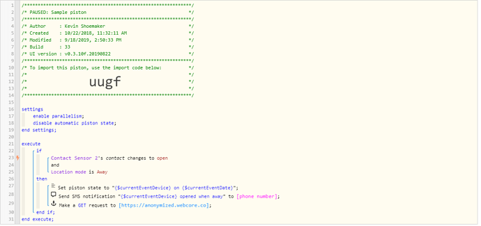

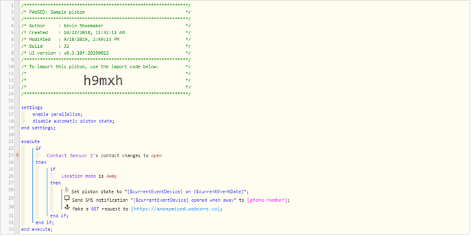

Conditions on the trigger or the action?
Does it matter where you place the conditions. Specifically, is it better to test the condition in the trigger or in the action?
Does it even matter?
It seems to work fine in either place, so I’m really just curious.

It should work the same way. I’d use the second option if I needed more evaluation of conditions down the line.
I agree with @eibyer. I tend to indent conditions underneath the trigger since it allows for more complex logic.
