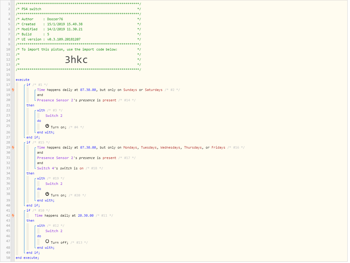

Conflict between actions?
Action doesn´t fire on work days
**2) What is the expected behavior?
If it is saturday or sunday and presence sensor 2 is present, the switch should come on at 07.30. This bit works
If it is a work day, presence sensor 2 is present and switch 4 is on, the switch should come on at 07.30. This bit doesn´t work.
If it is 20.30 the switch should turn off. This bit works.
On work days the switch does not turn on.
My guess is that there is a conflict between the 2 “on” actions, but cannot get my head around it.
I believe the trigger happens, and then the “only on” part is evaluated. The top block will be evaluated, and if it isn’t the right day, the trigger will be ignored. It won’t trigger both blocks to see which should be run. I’d try changing the time on one of the blocks to 7:29 as that will create two different triggers. The other option is to have one if block that triggers every day, and then have an if check inside to see if it is the weekend or a weekday.

Option 2 would be something like this:
if time 7:30 and presence sensor 2 is present
then
  if $dayOfWeek is in range 6 to 7.   [Saturday or Sunday]
    or
     {$dayOfWeek is in range 1 to 5 and Switch 4 is on}. [note this needs to be a group condition]
  then
     turn on switch 2
  endif
endif
if time is 2030
then
  turn off switch 2
endif
Hope this makes sense.
