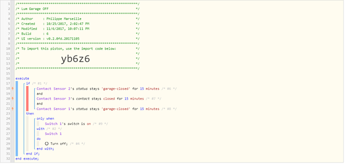

I have 2 multi sensors on garage doors (tilt) and one with a magnet on the home to garage access door. I want to turn off the lights of the garage after 15min of all doors been closed
Lights turn off after 15min
Lights aren’t turning on after 15min…
11/6/2017, 10:42:31 PM +417ms +0ms ╔Received event [Home].time = 1510026152650 with a delay of -1234ms +370ms ║RunTime Analysis CS > 14ms > PS > 250ms > PE > 106ms > CE +383ms ║Runtime (38469 bytes) successfully initialized in 250ms (v0.2.0fd.20171105) (381ms) +384ms ║╔Execution stage started +397ms ║║Cancelling condition #7's schedules... +398ms ║║Condition #7 evaluated true (2ms) +411ms ║║Comparison (string) garage-closed stays (string) garage-closed = true (3ms) +419ms ║║Adding a timed trigger schedule for condition 8 +423ms ║║Cancelling condition #8's schedules... +424ms ║║Condition #8 evaluated false (25ms) +426ms ║║Condition group #1 evaluated false (state did not change) (31ms) +429ms ║╚Execution stage complete. (45ms) +431ms ║Setting up scheduled job for Mon, Nov 6 2017 @ 10:57:31 PM EST (in 899.99s) +447ms ╚Event processed successfully (448ms) 11/6/2017, 10:27:32 PM +418ms +1ms ╔Received event [Home].time = 1510025253062 with a delay of -645ms +180ms ║RunTime Analysis CS > 29ms > PS > 65ms > PE > 86ms > CE +193ms ║Runtime (38465 bytes) successfully initialized in 65ms (v0.2.0fd.20171105) (191ms) +196ms ║╔Execution stage started +207ms ║║Cancelling condition #6's schedules... +208ms ║║Condition #6 evaluated true (2ms) +223ms ║║Comparison (enum) closed stays (string) closed = true (3ms) +231ms ║║Adding a timed trigger schedule for condition 7 +236ms ║║Cancelling condition #7's schedules... +237ms ║║Condition #7 evaluated false (27ms) +239ms ║║Condition group #1 evaluated false (state did not change) (34ms) +244ms ║╚Execution stage complete. (49ms) +247ms ║Setting up scheduled job for Mon, Nov 6 2017 @ 10:42:32 PM EST (in 899.986s) +265ms ╚Event processed successfully (264ms) 11/6/2017, 10:13:50 PM +832ms +1ms ╔Received event [Porte Maison Garage].contact = closed with a delay of 476ms +298ms ║RunTime Analysis CS > 161ms > PS > 60ms > PE > 77ms > CE +313ms ║Runtime (38476 bytes) successfully initialized in 60ms (v0.2.0fd.20171105) (311ms) +314ms ║╔Execution stage started +330ms ║║Comparison (string) garage-closed stays (string) garage-closed = true (2ms) +332ms ║║Condition #6 evaluated false (13ms) +334ms ║║Condition group #1 evaluated false (state did not change) (14ms) +337ms ║╚Execution stage complete. (23ms) +338ms ║Setting up scheduled job for Mon, Nov 6 2017 @ 10:27:33 PM EST (in 821.893s) +354ms ╚Event processed successfully (353ms)

All of contact1, contact2, and contact3 stay closed for 15 minutes...

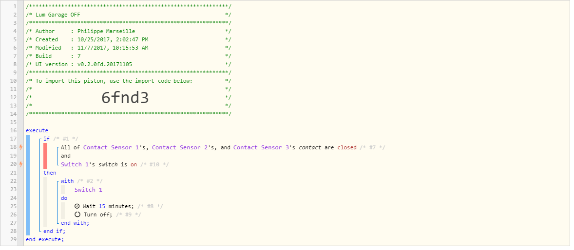

an easier way would be
If all doors are closed AND light is on
then
Wait 15 minutes, turn lights off
That way if you open a door, it cancels the timer and once you close it, the timer restarts
Trying this :
For some reason I though the “wait for 15min then …” wouldn’t be reset… and then I remember a property in Core (not webcore) that it would reset timers if the condition changed… is that what’s happening here?
webcore default is cancel on condition state change, click the WITH and then the cog (wheel) icon to bring up the options.
Exactly what I meant to say - condition state change.
Seems to be working fine now.
