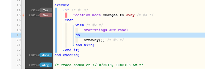

Hi Folks,
I am trying to set my ADT hub state to Arm/Away when location is Away.
I have the opposite running correctly when location is set to Home to Disarm ADT but no dice for arming. Any help would be appreciated.
How do you get the ADT panel to show up in webcore? Sorry if this is not the right place to ask but I could not find the answer by searching in the forums.
For arming (both kinds) you need to add an additional string parameter – the following all work for me:
disarm()
armAway(armedAway)
armStay(armedStay)
(note the additional “ed” in the string parameters).

Also, this worked perfect.
Awesome, That worked perfectly. Thank You!
