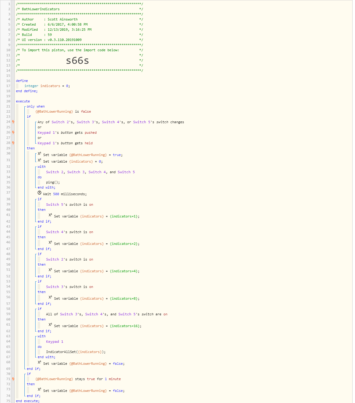

I have several Cooper RFWC5 controllers for my Zwave setup. It is an in wall zwave scene controller with 5 buttons. I have each button set up with associations to turn on lights and combinations of lights. The RFWC5 has and indicator by each button. The indicator basically determines what command will be sent if the button is pushed. If the indicator is off the button will send and ON command. If the indicator on the button will send an OFF command. Normally this works quite nicely to control a light or relay. The problem starts when the light gets controlled by something else. Then the light and button are out of sync and a double press is required to get the desired response. The RFWC5 allows the indicators to be set externally. The DH uses an integer where each bit represents an indicator state. Send 0 and they are all off. Send 1 and the first one comes on…
The piston I created is to keep the indicators in sync with the state of each light.
The problem is that is frequently gets out of sync and I’m not able to figure out why. When I test it works and works well. Then it will just not do what it is supposed to do. I’ve added in a bit of logic to ensure it is not running multiple instances when the button is double or triple pushed. However, it still seems to randomly get it wrong. I feels to me like ST or WebCore is not getting the correct state of the light, or the timing is wrong.
After piston execution the indicators should match the state each light/s.
Frequently (10-20%) of the time it is wrong. Seems to be more common on indicator 1. Not sure if that is because it is the most frequently used or if it is something in the program. I often find an indicator on when the light is off or off when light is on.
Looking for any input on what I may be missing, doing wrong, need to try.

+820ms ║║Calculating (integer) 0 + (integer) 1 >> (integer) 1
+823ms ║║Executed virtual command setVariable (1ms)
+832ms ║║Comparison (enum) off is (string) on = false (1ms)
+834ms ║║Condition #38 evaluated false (7ms)
+835ms ║║Condition group #33 evaluated false (state did not change) (8ms)
+842ms ║║Comparison (enum) off is (string) on = false (1ms)
+844ms ║║Condition #44 evaluated false (7ms)
+845ms ║║Condition group #39 evaluated false (state did not change) (7ms)
+852ms ║║Comparison (enum) off is (string) on = false (1ms)
+853ms ║║Condition #72 evaluated false (6ms)
+854ms ║║Condition group #69 evaluated false (state did not change) (7ms)
+867ms ║║Comparison (enum) off is (string) on = false (1ms)
+868ms ║║Condition #50 evaluated false (11ms)
+869ms ║║Condition group #45 evaluated false (state did not change) (12ms)
+872ms ║║Cancelling statement #75’s schedules…
+982ms ║║Executed physical command [Bath Lower Control].IndicatorAllSet([1]) (105ms)
+983ms ║║Executed [Bath Lower Control].IndicatorAllSet (107ms)
+985ms ║║Cancelling statement #83’s schedules…
+989ms ║║Executed virtual command setVariable (1ms)
+996ms ║║Comparison (boolean) false stays (boolean) true = false (1ms)
+998ms ║║Cancelling any timed trigger schedules for condition 87
+999ms ║║Cancelling statement #87’s schedules…
+1000ms ║║Condition #87 evaluated false (7ms)
+1001ms ║║Condition group #86 evaluated false (state did not change) (8ms)
+1002ms ║╚Execution stage complete. (863ms)
+1003ms ╚Event processed successfully (1004ms)
12/20/2019, 8:14:28 AM +205ms
+1ms ╔Received event [Bath Lower Vanity Light].switch = on with a delay of 87ms
+9396ms ║RunTime Analysis CS > 20ms > PS > 9309ms > PE > 66ms > CE
+9397ms ║Piston waited at a semaphore for 9264ms
+9399ms ║Runtime (45598 bytes) successfully initialized in 9309ms (v0.3.110.20191009) (9397ms)
+9400ms ║╔Execution stage started
+9408ms ║║Comparison (boolean) false is (boolean) false = true (1ms)
+9409ms ║║Condition #85 evaluated true (5ms)
+9410ms ║║Condition group #23 evaluated true (state did not change) (6ms)
+9424ms ║║Comparison (enum) on changes = false (0ms)
+9426ms ║║Condition #77 evaluated false (15ms)
+9432ms ║║Cancelling condition #79’s schedules…
+9433ms ║║Condition #79 evaluated false (6ms)
+9438ms ║║Condition #80 evaluated false (4ms)
+9439ms ║║Cancelling condition #23’s schedules…
+9440ms ║║Condition group #23 evaluated false (state changed) (29ms)
+9446ms ║║Comparison (boolean) false stays (boolean) true = false (2ms)
+9448ms ║║Cancelling any timed trigger schedules for condition 87
+9449ms ║║Cancelling statement #87’s schedules…
+9450ms ║║Condition #87 evaluated false (7ms)
+9451ms ║║Condition group #86 evaluated false (state did not change) (8ms)
+9452ms ║╚Execution stage complete. (52ms)
+9453ms ╚Event processed successfully (9453ms)
12/20/2019, 8:14:27 AM +338ms
+1ms ╔Received event [Bath Lower Control].button = pushed with a delay of 93ms
+127ms ║RunTime Analysis CS > 20ms > PS > 50ms > PE > 57ms > CE
+130ms ║Runtime (45521 bytes) successfully initialized in 50ms (v0.3.110.20191009) (128ms)
+138ms ║║Comparison (boolean) false is (boolean) false = true (1ms)
+139ms ║║Condition #85 evaluated true (4ms)
+140ms ║║Condition group #23 evaluated true (state did not change) (6ms)
+157ms ║║Condition #77 evaluated false (16ms)
+161ms ║║Comparison (enum) pushed gets (string) pushed = true (1ms)
+162ms ║║Condition #79 evaluated true (4ms)
+163ms ║║Condition group #23 evaluated true (state did not change) (22ms)
+165ms ║║Cancelling statement #81’s schedules…
+169ms ║║Executed virtual command setVariable (0ms)
+172ms ║║Executed virtual command setVariable (1ms)
+174ms ║║Cancelling statement #52’s schedules…
+248ms ║║Executed physical command [Bath Lower Fan].ping() (71ms)
+249ms ║║Executed [Bath Lower Fan].ping (73ms)
+266ms ║║Executed physical command [Bath Lower Heater].ping() (15ms)
+267ms ║║Executed [Bath Lower Heater].ping (16ms)
+281ms ║║Executed physical command [Bath Lower Light].ping() (13ms)
+282ms ║║Executed [Bath Lower Light].ping (15ms)
+296ms ║║Executed physical command [Bath Lower Vanity Light].ping() (13ms)
+297ms ║║Executed [Bath Lower Vanity Light].ping (14ms)
+300ms ║║Cancelling statement #57’s schedules…
+303ms ║║Executed virtual command wait (0ms)
+304ms ║║Waiting for 500ms
+812ms ║║Comparison (enum) off is (string) on = false (1ms)
+814ms ║║Condition #32 evaluated false (8ms)
+815ms ║║Condition group #27 evaluated false (state did not change) (9ms)
+822ms ║║Comparison (enum) off is (string) on = false (1ms)
+824ms ║║Condition #38 evaluated false (7ms)
+825ms ║║Condition group #33 evaluated false (state did not change) (8ms)
+833ms ║║Comparison (enum) off is (string) on = false (2ms)
+834ms ║║Condition #44 evaluated false (7ms)
+835ms ║║Condition group #39 evaluated false (state did not change) (8ms)
+843ms ║║Comparison (enum) off is (string) on = false (2ms)
+844ms ║║Condition #72 evaluated false (6ms)
+845ms ║║Condition group #69 evaluated false (state did not change) (8ms)
+858ms ║║Comparison (enum) off is (string) on = false (2ms)
+860ms ║║Condition #50 evaluated false (12ms)
+861ms ║║Condition group #45 evaluated false (state did not change) (13ms)
+863ms ║║Cancelling statement #75’s schedules…
+969ms ║║Executed physical command [Bath Lower Control].IndicatorAllSet([0]) (102ms)
+970ms ║║Executed [Bath Lower Control].IndicatorAllSet (104ms)
+973ms ║║Cancelling statement #83’s schedules…
+976ms ║║Executed virtual command setVariable (1ms)
+983ms ║║Comparison (boolean) false stays (boolean) true = false (2ms)
+985ms ║║Cancelling any timed trigger schedules for condition 87
+985ms ║║Cancelling statement #87’s schedules…
+986ms ║║Condition #87 evaluated false (7ms)
+987ms ║║Condition group #86 evaluated false (state did not change) (8ms)
+989ms ║╚Execution stage complete. (859ms)
+990ms ╚Event processed successfully (990ms)
12/20/2019, 8:14:25 AM +2ms
+1ms ╔Received event [Bath Lower Control].button = pushed with a delay of 87ms
+138ms ║RunTime Analysis CS > 19ms > PS > 61ms > PE > 57ms > CE
+141ms ║Runtime (45518 bytes) successfully initialized in 61ms (v0.3.110.20191009) (138ms)
+150ms ║║Comparison (boolean) false is (boolean) false = true (1ms)
+151ms ║║Condition #85 evaluated true (5ms)
+152ms ║║Cancelling condition #23’s schedules…
+153ms ║║Condition group #23 evaluated true (state changed) (7ms)
+170ms ║║Condition #77 evaluated false (16ms)
+174ms ║║Comparison (enum) pushed gets (string) pushed = true (1ms)
+176ms ║║Cancelling condition #79’s schedules…
+177ms ║║Condition #79 evaluated true (5ms)
+178ms ║║Condition group #23 evaluated true (state did not change) (23ms)
+180ms ║║Cancelling statement #81’s schedules…
+183ms ║║Executed virtual command setVariable (1ms)
+187ms ║║Executed virtual command setVariable (1ms)
+190ms ║║Cancelling statement #52’s schedules…
+208ms ║║Executed physical command [Bath Lower Fan].ping() (14ms)
+209ms ║║Executed [Bath Lower Fan].ping (16ms)
+222ms ║║Executed physical command [Bath Lower Heater].ping() (12ms)
+223ms ║║Executed [Bath Lower Heater].ping (14ms)
+237ms ║║Executed physical command [Bath Lower Light].ping() (11ms)
+237ms ║║Executed [Bath Lower Light].ping (13ms)
+251ms ║║Executed physical command [Bath Lower Vanity Light].ping() (12ms)
+252ms ║║Executed [Bath Lower Vanity Light].ping (13ms)
+254ms ║║Cancelling statement #57’s schedules…
+258ms ║║Executed virtual command wait (0ms)
+258ms ║║Waiting for 500ms
+767ms ║║Comparison (enum) off is (string) on = false (2ms)
+769ms ║║Cancelling condition #32’s schedules…
+770ms ║║Condition #32 evaluated false (8ms)
+771ms ║║Cancelling condition #27’s schedules…
+771ms ║║Condition group #27 evaluated false (state changed) (10ms)
+779ms ║║Comparison (enum) off is (string) on = false (1ms)
+781ms ║║Condition #38 evaluated false (6ms)
+782ms ║║Condition group #33 evaluated false (state did not change) (7ms)
+790ms ║║Comparison (enum) off is (string) on = false (1ms)
+792ms ║║Condition #44 evaluated false (7ms)
+792ms ║║Condition group #39 evaluated false (state did not change) (8ms)
+801ms ║║Comparison (enum) off is (string) on = false (2ms)
+802ms ║║Condition #72 evaluated false (7ms)
+803ms ║║Condition group #69 evaluated false (state did not change) (8ms)
+817ms ║║Comparison (enum) off is (string) on = false (2ms)
+819ms ║║Condition #50 evaluated false (12ms)
+820ms ║║Condition group #45 evaluated false (state did not change) (14ms)
+822ms ║║Cancelling statement #75’s schedules…
+846ms ║║Executed physical command [Bath Lower Control].IndicatorAllSet([0]) (19ms)
+847ms ║║Executed [Bath Lower Control].IndicatorAllSet (21ms)
+849ms ║║Cancelling statement #83’s schedules…
+853ms ║║Executed virtual command setVariable (1ms)
+859ms ║║Comparison (boolean) false stays (boolean) true = false (1ms)
+861ms ║║Cancelling any timed trigger schedules for condition 87
+862ms ║║Cancelling statement #87’s schedules…
+863ms ║║Condition #87 evaluated false (7ms)
+863ms ║║Condition group #86 evaluated false (state did not change) (8ms)
+865ms ║╚Execution stage complete. (724ms)
+867ms ╚Event processed successfully (866ms)
12/20/2019, 8:10:47 AM +761ms
+1ms ╔Received event…= @BathLowerRunning with a delay of 64ms
+122ms ║RunTime Analysis CS > 18ms > PS > 42ms > PE > 62ms > CE
+125ms ║Runtime (45544 bytes) successfully initialized in 42ms (v0.3.110.20191009) (124ms)
+223ms ║║Comparison (boolean) false is (boolean) false = true (1ms)
+224ms ║║Cancelling condition #85’s schedules…
+225ms ║║Condition #85 evaluated true (95ms)
+226ms ║║Condition group #23 evaluated true (state did not change) (96ms)
+243ms ║║Cancelling condition #77’s schedules…
+244ms ║║Condition #77 evaluated false (17ms)
+250ms ║║Cancelling condition #79’s schedules…
+251ms ║║Condition #79 evaluated false (6ms)
+256ms ║║Condition #80 evaluated false (4ms)
+257ms ║║Cancelling condition #23’s schedules…
+257ms ║║Condition group #23 evaluated false (state changed) (30ms)
+263ms ║║Comparison (boolean) false stays (boolean) true = false (1ms)
+265ms ║║Cancelling any timed trigger schedules for condition 87
+266ms ║║Cancelling statement #87’s schedules…
+267ms ║║Cancelling condition #87’s schedules…
+268ms ║║Condition #87 evaluated false (7ms)
+268ms ║║Cancelling condition #86’s schedules…
+269ms ║║Condition group #86 evaluated false (state changed) (10ms)
+271ms ║╚Execution stage complete. (145ms)
+272ms ╚Event processed successfully (272ms)
12/20/2019, 8:10:47 AM +39ms
+0ms ╔Received event…time = 1576851040036 with a delay of 7002ms
+558ms ║RunTime Analysis CS > 229ms > PS > 271ms > PE > 59ms > CE
+561ms ║Runtime (45520 bytes) successfully initialized in 271ms (v0.3.110.20191009) (560ms)
+562ms ║╔Execution stage started
+570ms ║║Cancelling condition #23’s schedules…
+604ms ║║Cancelling condition #87’s schedules…
+605ms ║║Condition #87 evaluated true (2ms)
+606ms ║║Cancelling condition #86’s schedules…
+607ms ║║Condition group #86 evaluated true (state changed) (5ms)
+610ms ║║Cancelling statement #88’s schedules…
+615ms ║║Executed virtual command setVariable (1ms)
+617ms ║╚Execution stage complete. (55ms)
+618ms ╚Event processed successfully (619ms)
12/20/2019, 8:09:39 AM +888ms
+0ms ╔Received event [SAAINS Home].:de078d7ee8065d88dd14ecaf1ff0f7be: = @BathLowerRunning with a delay of 62ms
+125ms ║RunTime Analysis CS > 20ms > PS > 43ms > PE > 63ms > CE
+128ms ║Runtime (45549 bytes) successfully initialized in 43ms (v0.3.110.20191009) (127ms)
+136ms ║║Comparison (boolean) true is (boolean) false = false (2ms)
+137ms ║║Cancelling condition #85’s schedules…
+138ms ║║Condition #85 evaluated false (5ms)
+139ms ║║Cancelling condition #23’s schedules…
+140ms ║║Condition group #23 evaluated false (state changed) (8ms)
+146ms ║║Comparison (boolean) true stays (boolean) true = true (1ms)
+147ms ║║Adding a timed trigger schedule for condition 87
+149ms ║║Condition #87 evaluated false (7ms)
+150ms ║║Condition group #86 evaluated false (state did not change) (8ms)
+153ms ║╚Execution stage complete. (24ms)
+154ms ║Setting up scheduled job for Fri, Dec 20 2019 @ 8:10:40 AM CST (in 59.995s)
+166ms ╚Event processed successfully (167ms)
12/20/2019, 8:09:30 AM +234ms
+0ms ╔Received event [Bath Lower Vanity Light].switch = off with a delay of 76ms
+9435ms ║RunTime Analysis CS > 19ms > PS > 9353ms > PE > 63ms > CE
+9436ms ║Piston waited at a semaphore for 9307ms
+9438ms ║Runtime (45594 bytes) successfully initialized in 9353ms (v0.3.110.20191009) (9437ms)
+9439ms ║╔Execution stage started
+9446ms ║║Comparison (boolean) false is (boolean) false = true (1ms)
+9448ms ║║Condition #85 evaluated true (4ms)
+9448ms ║║Condition group #23 evaluated true (state did not change) (5ms)
+9463ms ║║Comparison (enum) off changes = true (1ms)
+9465ms ║║Cancelling condition #77’s schedules…
+9466ms ║║Condition #77 evaluated true (16ms)
+9467ms ║║Condition group #23 evaluated true (state did not change) (17ms)
+9469ms ║║Cancelling statement #81’s schedules…
+9472ms ║║Executed virtual command setVariable (1ms)
+9475ms ║║Executed virtual command setVariable (1ms)
+9478ms ║║Cancelling statement #52’s schedules…
+9493ms ║║Executed physical command [Bath Lower Fan].ping() (12ms)
+9494ms ║║Executed [Bath Lower Fan].ping (14ms)
+9507ms ║║Executed physical command [Bath Lower Heater].ping() (11ms)
+9508ms ║║Executed [Bath Lower Heater].ping (12ms)
+9520ms ║║Executed physical command [Bath Lower Light].ping() (11ms)
+9521ms ║║Executed [Bath Lower Light].ping (13ms)
+9534ms ║║Executed physical command [Bath Lower Vanity Light].ping() (10ms)
+9534ms ║║Executed [Bath Lower Vanity Light].ping (12ms)
+9537ms ║║Cancelling statement #57’s schedules…
+9540ms ║║Executed virtual command wait (1ms)
+9541ms ║║Requesting a wake up for Fri, Dec 20 2019 @ 8:09:40 AM CST (in 0.5s)
+9544ms ║╚Execution stage complete. (105ms)
+9546ms ║Setting up scheduled job for Fri, Dec 20 2019 @ 8:09:40 AM CST (in 1s)
+9556ms ╚Event processed successfully (9556ms)
12/20/2019, 8:09:29 AM +291ms
+1ms ╔Received event [Bath Lower Control].button = pushed with a delay of 775ms
+116ms ║RunTime Analysis CS > 19ms > PS > 38ms > PE > 59ms > CE
+119ms ║Runtime (45520 bytes) successfully initialized in 38ms (v0.3.110.20191009) (116ms)
+127ms ║║Comparison (boolean) false is (boolean) false = true (1ms)
+128ms ║║Condition #85 evaluated true (4ms)
+129ms ║║Cancelling condition #23’s schedules…
+130ms ║║Condition group #23 evaluated true (state changed) (7ms)
+146ms ║║Condition #77 evaluated false (15ms)
+150ms ║║Comparison (enum) pushed gets (string) pushed = true (1ms)
+151ms ║║Cancelling condition #79’s schedules…
+152ms ║║Condition #79 evaluated true (5ms)
+153ms ║║Condition group #23 evaluated true (state did not change) (22ms)
+155ms ║║Cancelling statement #81’s schedules…
+158ms ║║Executed virtual command setVariable (1ms)
+162ms ║║Executed virtual command setVariable (0ms)
+164ms ║║Cancelling statement #52’s schedules…
+230ms ║║Executed physical command [Bath Lower Fan].ping() (63ms)
+231ms ║║Executed [Bath Lower Fan].ping (65ms)
+246ms ║║Executed physical command [Bath Lower Heater].ping() (12ms)
+247ms ║║Executed [Bath Lower Heater].ping (14ms)
+261ms ║║Executed physical command [Bath Lower Light].ping() (13ms)
+262ms ║║Executed [Bath Lower Light].ping (14ms)
+275ms ║║Executed physical command [Bath Lower Vanity Light].ping() (12ms)
+276ms ║║Executed [Bath Lower Vanity Light].ping (14ms)
+278ms ║║Cancelling statement #57’s schedules…
+281ms ║║Executed virtual command wait (0ms)
+282ms ║║Waiting for 500ms
+790ms ║║Comparison (enum) on is (string) on = true (1ms)
+792ms ║║Cancelling condition #32’s schedules…
+793ms ║║Condition #32 evaluated true (8ms)
+794ms ║║Cancelling condition #27’s schedules…
+795ms ║║Condition group #27 evaluated true (state changed) (10ms)
+797ms ║║Cancelling statement #63’s schedules…
+801ms ║║Calculating (integer) 0 + (integer) 1 >> (integer) 1
+804ms ║║Executed virtual command setVariable (1ms)
+813ms ║║Comparison (enum) off is (string) on = false (2ms)
+814ms ║║Condition #38 evaluated false (7ms)
+815ms ║║Condition group #33 evaluated false (state did not change) (8ms)
+823ms ║║Comparison (enum) off is (string) on = false (2ms)
+824ms ║║Condition #44 evaluated false (7ms)
+825ms ║║Condition group #39 evaluated false (state did not change) (8ms)
+834ms ║║Comparison (enum) off is (string) on = false (1ms)
+835ms ║║Condition #72 evaluated false (8ms)
+836ms ║║Condition group #69 evaluated false (state did not change) (9ms)
+849ms ║║Comparison (enum) off is (string) on = false (2ms)
+851ms ║║Condition #50 evaluated false (12ms)
+852ms ║║Condition group #45 evaluated false (state did not change) (13ms)
+854ms ║║Cancelling statement #75’s schedules…
+971ms ║║Executed physical command [Bath Lower Control].IndicatorAllSet([1]) (112ms)
+971ms ║║Executed [Bath Lower Control].IndicatorAllSet (114ms)
+974ms ║║Cancelling statement #83’s schedules…
+977ms ║║Executed virtual command setVariable (1ms)
+984ms ║║Comparison (boolean) false stays (boolean) true = false (2ms)
+986ms ║║Cancelling any timed trigger schedules for condition 87
+986ms ║║Cancelling statement #87’s schedules…
+987ms ║║Condition #87 evaluated false (7ms)
+988ms ║║Condition group #86 evaluated false (state did not change) (8ms)
+990ms ║╚Execution stage complete. (871ms)
+991ms ╚Event processed successfully (991ms)

I did not go thru your log, but normally, I try to avoid this logic:
  • IF button is pressed, then change light…
  • IF light changes, then change button…
It can create endless loops and/or semaphore delays…
Ideally, there should only be one master in control.
Pro Tip:
If webCoRE sees RFWC5’s indicator as separate from the RFWC5’s buttons, then please ignore this post.
How many other pistons do you have that utilize the controller? Could one of them be causing the problem? Post the piston for the indicator that’s frequently out of sync.
The buttons and the indicators are seperate. In terms of ST. When a button is pressed ST only knows a button was pressed. It does not know if the button press caused an indicator to turn on or off. Setting the state of the indicator via ST does not cause any button press actions in the RFWC5.
If you had any logic suggestions I would like to hear them.
Thanks for looking
That is the only piston the does any thing with the controller.
Does the switch have its own on-board programming? My Innovelli light switch can be set up to turn itself off after X minutes, regardless of ST or WC. My Kwikset lock is set up to lock itself after one minute. Look at its attributes in ST and see if there are any settings that can be turned on or off.
Did you add the global variable to fix an actual problem with multiple instances or because you assumed there might be a problem? Only webCoRE has the semaphore wait mechanism that gives running pistons ten seconds to finish before the new one is started and that seems like it should be plenty of time.
The timed trigger at the bottom, in particular, might perhaps be confusing the issue, though I haven’t thought about how it might do so. It does mean the global variable is a trigger so extra piston executions are happening and I’m not sure what that does to the global variable.
I added it because I perceived it was a problem. I can cut that out and watch what happens. The piston is no mission critical so right now I’ve just paused it to see if there is any funky action happening without it. I will monitor it for a week or so.
