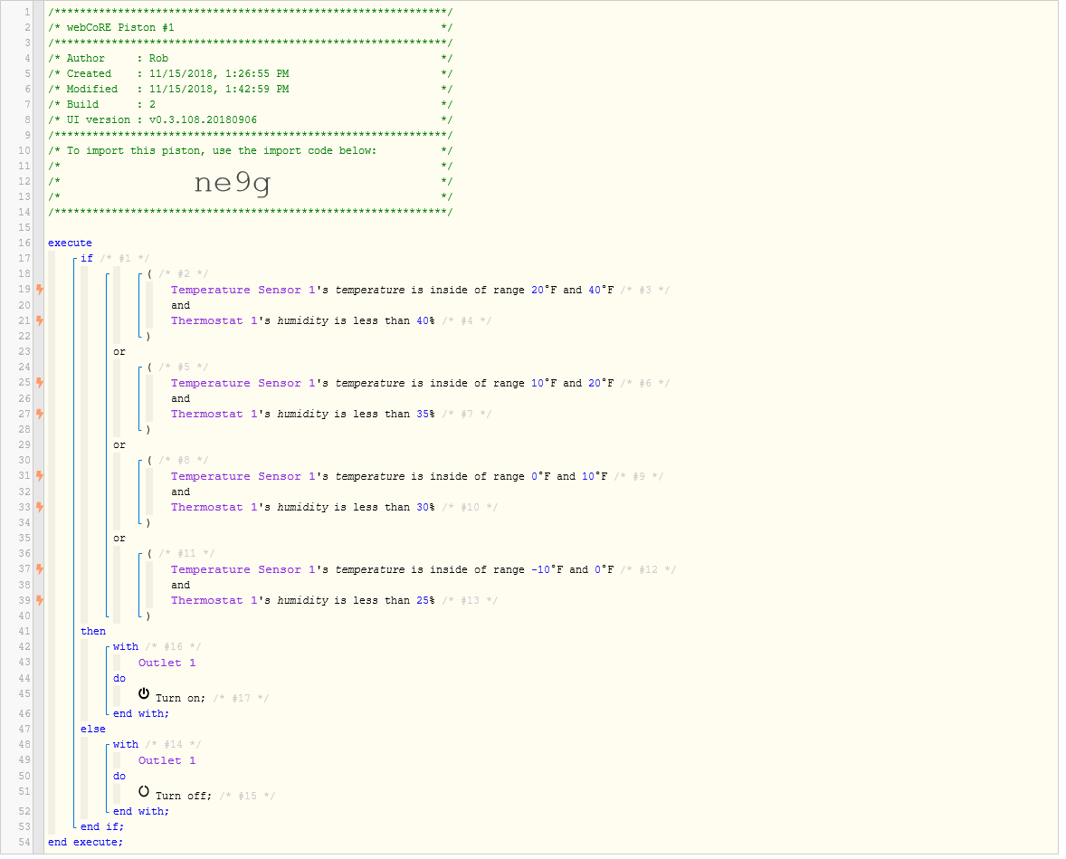

I have a console / whole house humidifier that I am looking to control based on the outside temps & an indoor humidity sensor.
Trying to keep the indoor Relative Humidity (RH) according to:
20° to 40° outside, RH <40% turn on OUTLET
10° to 20° outside, RH <35% turn on OUTLET
0° to 10° outside, RH <30% turn on OUTLET
-10° to 0° outside, RH <25% turn on OUTLET
I’m sure that I’ll have some latency but I imagine that I can resolve that once I get it running.
I know that I need to get the weatherstation add-on installed, but otherwise I honestly don’t know where to start with a piston for this.

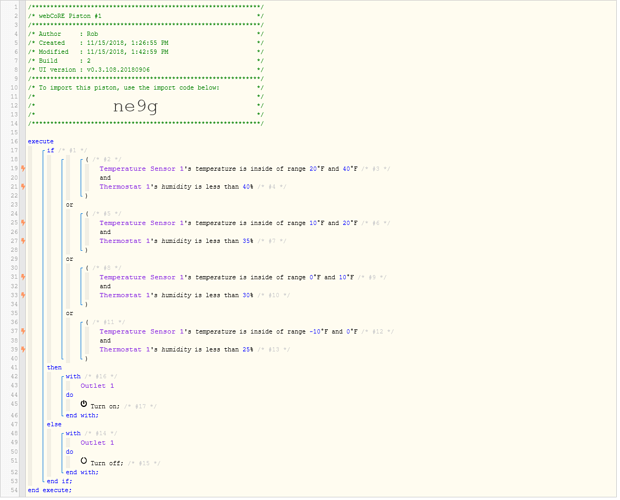

Sounds like you’ll be using a bunch of OR groups to me…
