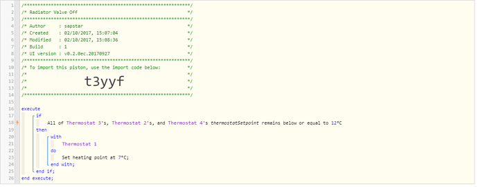

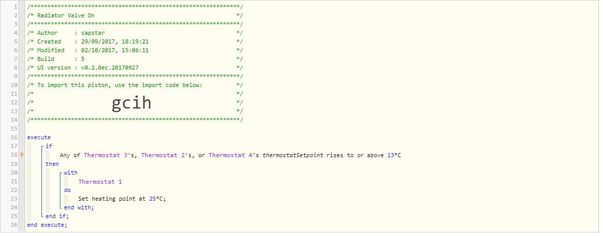

I have made some progress and included heating controls to set radiator valves to specific temperatures in my good night, good morning, I’m back and good bye routines.
I have created two pistons as below.

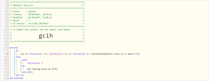

What I want to do is to set hive thermostat to 25, so that it keeps the boiler on when ever any of the radiator valves are set to temperatures above 13.

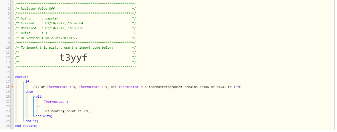

I want the thermostat to turn off as soon as the temperature on all the radiator valves reaches the desired temperature.
Is the above logic correct? I did a quick test by setting one of the radiator valve to 22 degrees and the remaining ones remained at 12. I was expecting hive to change to 25 but it didn’t.
I then tried to bring all the valves to 12, again this didn’t change hive to 7 as I set it up in the piston. What am I doing wrong?
Update: I was able to get the first piston working by changing “setpoint” to “heating setpoint”. The second one still doesn’t work.
