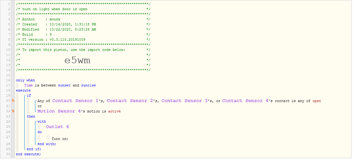

Hi,
I created a solution to keep the lights on until another door opens.

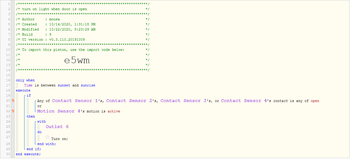

first I create a piston to turn on the light when any doors open.

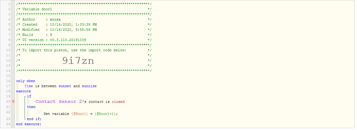

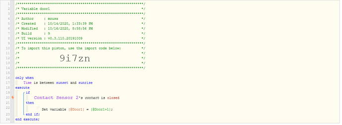

then I made a variable for each door, I have 5 doors and I just have 4 contact sensor, so I used 1 motion sensor to act when door open.
I made 5 of the above piston. each door has one.

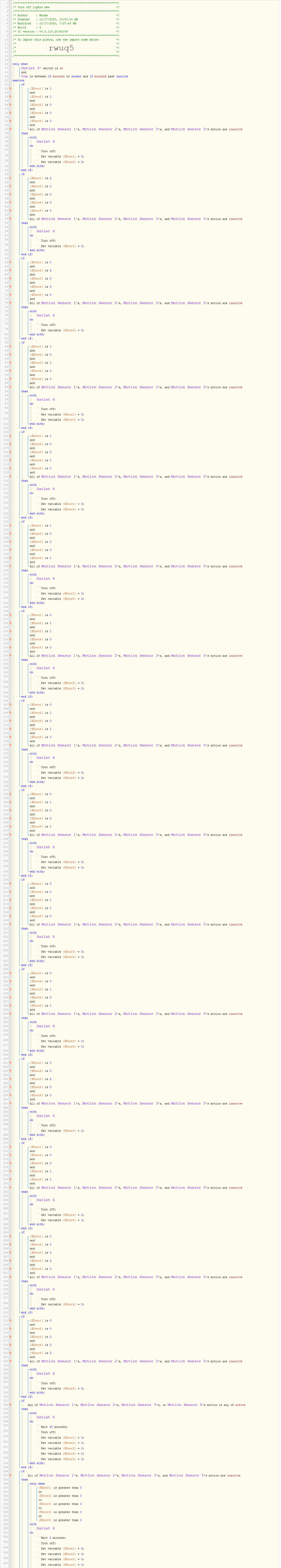

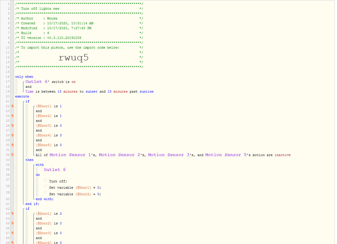

then I made a huge piston to turn off the lights when doors closed after targeted opening ways and there is no motion.
I believe there is a better way to do that or at least to decrease the number of pistons used, I’m open to any suggestions to make it better.
