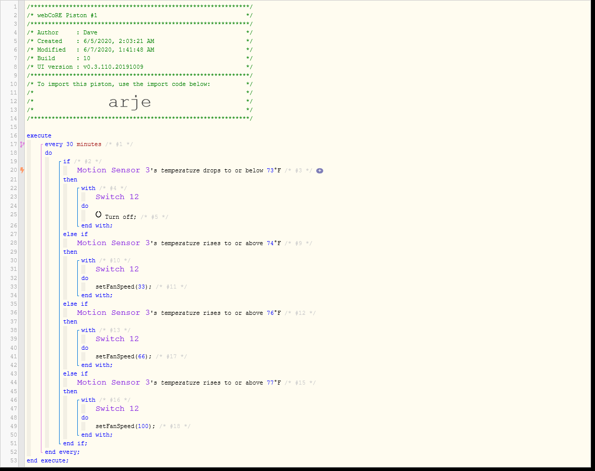

I am very new to WebCoRE and I have no programming experience, simple “if this, then that”
with SmartThings and Alexa experience.
I can’t get then fan to behave in the manner I would like.
If temp is at or less than 73F, turn off fan
If temp is at or higher than 74F, set fan to low (33%)
If temp is at or higher than 76F, set fan to medium (66%)
If temp is at or higher than 77F, set fan to high (100%)
Fan may be only be setting itself to one speed and not changing as it gets cooler
or warmer. Honestly doesn’t look like it is changing anything. I also need to have the sensor
checked for status updates as it will only update every hour or more on its own.
6/6/2020, 11:26:24 PM +863ms
+0ms ╔Starting piston… (v0.3.110.20191009)
+378ms ║╔Subscribing to devices…
+417ms ║║Subscribing to Master bedroom.temperature…
+496ms ║║Subscribing to Our Room Fan…
+497ms ║╚Finished subscribing (131ms)
+537ms ║Comparison (decimal) 75.0 is_less_than_or_equal_to (integer) 73 = false (1ms)
+549ms ║Comparison (decimal) 75.0 is_greater_than_or_equal_to (integer) 74 = true (2ms)
+559ms ║Comparison (decimal) 75.0 is_greater_than_or_equal_to (integer) 76 = false (1ms)
+569ms ║Comparison (decimal) 75.0 is_greater_than_or_equal_to (integer) 77 = false (2ms)
+582ms ║Setting up scheduled job for Sat, Jun 6 2020 @ 11:56:25 PM CDT (in 1799.939s)
+596ms ╚Piston successfully started (596ms)
