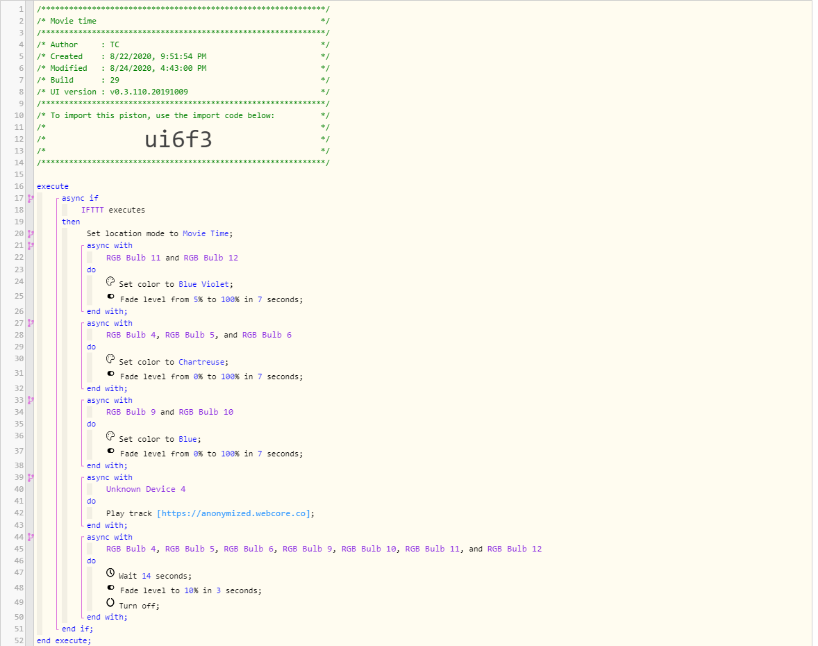

Lights seem to be flashing erratically, or at least not the way I want them to.
There are three sets of lights I want come on at the same time, fade from low to high, in three separate colors. An MP3 then plays on my Sonos (THX sound test), then the lights should all fade off and turn off at the same time.
Lights come on randomly/flash, then come up at different rates to full level. The MP3 plays great, then the lights dim randomly, flicker and flash off, or stay on.
|+0ms|╔Received event [Rose Manor].time = 1598283903917 with a delay of -839ms|
|+103ms|║RunTime Analysis CS > 18ms > PS > 59ms > PE > 26ms > CE|
|+105ms|║Runtime (40888 bytes) successfully initialized in 59ms (v0.3.110.20191009) (104ms)|
|+106ms|║╔Execution stage started|
|+138ms|║║Executed physical command [Chandelier N].off() (9ms)|
|+139ms|║║Executed [Chandelier N].off (13ms)|
|+152ms|║║Executed physical command [Chandelier SE].off() (9ms)|
|+153ms|║║Executed [Chandelier SE].off (11ms)|
|+165ms|║║Executed physical command [Chandelier SW].off() (9ms)|
|+166ms|║║Executed [Chandelier SW].off (11ms)|
|+178ms|║║Executed physical command [Sofa Sconce N].off() (8ms)|
|+179ms|║║Executed [Sofa Sconce N].off (11ms)|
|+191ms|║║Executed physical command [Sofa Sconce S].off() (8ms)|
|+192ms|║║Executed [Sofa Sconce S].off (10ms)|
|+203ms|║║Executed physical command [TV Sconce N].off() (8ms)|
|+204ms|║║Executed [TV Sconce N].off (9ms)|
|+214ms|║║Executed physical command [TV Sconce S].off() (8ms)|
|+215ms|║║Executed [TV Sconce S].off (10ms)|
|+217ms|║╚Execution stage complete. (111ms)|
|+218ms|╚Event processed successfully (218ms)|
|8/24/2020, 4:45:00 PM +75ms|
|+1ms|╔Received event [Rose Manor].time = 1598283901434 with a delay of -1359ms|
|+186ms|║RunTime Analysis CS > 24ms > PS > 121ms > PE > 41ms > CE|
|+190ms|║Runtime (40891 bytes) successfully initialized in 121ms (v0.3.110.20191009) (188ms)|
|+191ms|║╔Execution stage started|
|+259ms|║║Skipped execution of physical command [Chandelier N].setLevel([100]) because it would make no change to the device. (11ms)|
|+269ms|║║Executed physical command [Chandelier N].setLevel([85], [delay: 500]) (8ms)|
|+278ms|║║Executed physical command [Chandelier N].setLevel([70], [delay: 1000]) (8ms)|
|+285ms|║║Executed physical command [Chandelier N].setLevel([55], [delay: 1500]) (5ms)|
|+294ms|║║Executed physical command [Chandelier N].setLevel([40], [delay: 2000]) (7ms)|
|+302ms|║║Executed physical command [Chandelier N].setLevel([25], [delay: 2500]) (6ms)|
|+309ms|║║Executed physical command [Chandelier N].setLevel([10], [delay: 3000]) (5ms)|
|+317ms|║║Executed physical command [Chandelier N].setLevel([10], [delay: 3099]) (5ms)|
|+318ms|║║Executed virtual command [Chandelier N].fadeLevel (78ms)|
|+346ms|║║Skipped execution of physical command [Chandelier SE].setLevel([100]) because it would make no change to the device. (17ms)|
|+355ms|║║Executed physical command [Chandelier SE].setLevel([85], [delay: 500]) (7ms)|
|+361ms|║║Executed physical command [Chandelier SE].setLevel([70], [delay: 1000]) (4ms)|
|+367ms|║║Executed physical command [Chandelier SE].setLevel([55], [delay: 1500]) (5ms)|
|+373ms|║║Executed physical command [Chandelier SE].setLevel([40], [delay: 2000]) (4ms)|
|+378ms|║║Executed physical command [Chandelier SE].setLevel([25], [delay: 2500]) (5ms)|
|+384ms|║║Executed physical command [Chandelier SE].setLevel([10], [delay: 3000]) (5ms)|
|+389ms|║║Executed physical command [Chandelier SE].setLevel([10], [delay: 3099]) (4ms)|
|+390ms|║║Executed virtual command [Chandelier SE].fadeLevel (68ms)|
|+411ms|║║Skipped execution of physical command [Chandelier SW].setLevel([100]) because it would make no change to the device. (11ms)|
|+419ms|║║Executed physical command [Chandelier SW].setLevel([85], [delay: 500]) (7ms)|
|+426ms|║║Executed physical command [Chandelier SW].setLevel([70], [delay: 1000]) (5ms)|
|+431ms|║║Executed physical command [Chandelier SW].setLevel([55], [delay: 1500]) (4ms)|
|+438ms|║║Executed physical command [Chandelier SW].setLevel([40], [delay: 2000]) (6ms)|
|+443ms|║║Executed physical command [Chandelier SW].setLevel([25], [delay: 2500]) (3ms)|
|+455ms|║║Executed physical command [Chandelier SW].setLevel([10], [delay: 3000]) (11ms)|
|+462ms|║║Executed physical command [Chandelier SW].setLevel([10], [delay: 3099]) (6ms)|
|+463ms|║║Executed virtual command [Chandelier SW].fadeLevel (70ms)|
|+483ms|║║Skipped execution of physical command [Sofa Sconce N].setLevel([100]) because it would make no change to the device. (11ms)|
|+495ms|║║Executed physical command [Sofa Sconce N].setLevel([85], [delay: 500]) (10ms)|
|+499ms|║║Executed physical command [Sofa Sconce N].setLevel([70], [delay: 1000]) (3ms)|
|+506ms|║║Executed physical command [Sofa Sconce N].setLevel([55], [delay: 1500]) (5ms)|
|+514ms|║║Executed physical command [Sofa Sconce N].setLevel([40], [delay: 2000]) (6ms)|
|+521ms|║║Executed physical command [Sofa Sconce N].setLevel([25], [delay: 2500]) (5ms)|
|+527ms|║║Executed physical command [Sofa Sconce N].setLevel([10], [delay: 3000]) (5ms)|
|+534ms|║║Executed physical command [Sofa Sconce N].setLevel([10], [delay: 3099]) (5ms)|
|+535ms|║║Executed virtual command [Sofa Sconce N].fadeLevel (70ms)|
|+556ms|║║Skipped execution of physical command [Sofa Sconce S].setLevel([100]) because it would make no change to the device. (11ms)|
|+563ms|║║Executed physical command [Sofa Sconce S].setLevel([85], [delay: 500]) (6ms)|
|+568ms|║║Executed physical command [Sofa Sconce S].setLevel([70], [delay: 1000]) (4ms)|
|+576ms|║║Executed physical command [Sofa Sconce S].setLevel([55], [delay: 1500]) (7ms)|
|+581ms|║║Executed physical command [Sofa Sconce S].setLevel([40], [delay: 2000]) (4ms)|
|+587ms|║║Executed physical command [Sofa Sconce S].setLevel([25], [delay: 2500]) (4ms)|
|+593ms|║║Executed physical command [Sofa Sconce S].setLevel([10], [delay: 3000]) (5ms)|
|+600ms|║║Executed physical command [Sofa Sconce S].setLevel([10], [delay: 3099]) (5ms)|
|+600ms|║║Executed virtual command [Sofa Sconce S].fadeLevel (62ms)|
|+623ms|║║Skipped execution of physical command [TV Sconce N].setLevel([100]) because it would make no change to the device. (12ms)|
|+631ms|║║Executed physical command [TV Sconce N].setLevel([85], [delay: 500]) (6ms)|
|+638ms|║║Executed physical command [TV Sconce N].setLevel([70], [delay: 1000]) (5ms)|
|+644ms|║║Executed physical command [TV Sconce N].setLevel([55], [delay: 1500]) (4ms)|
|+651ms|║║Executed physical command [TV Sconce N].setLevel([40], [delay: 2000]) (6ms)|
|+658ms|║║Executed physical command [TV Sconce N].setLevel([25], [delay: 2500]) (6ms)|
|+663ms|║║Executed physical command [TV Sconce N].setLevel([10], [delay: 3000]) (4ms)|
|+669ms|║║Executed physical command [TV Sconce N].setLevel([10], [delay: 3099]) (5ms)|
|+671ms|║║Executed virtual command [TV Sconce N].fadeLevel (67ms)|
|+692ms|║║Skipped execution of physical command [TV Sconce S].setLevel([100]) because it would make no change to the device. (11ms)|
|+701ms|║║Executed physical command [TV Sconce S].setLevel([85], [delay: 500]) (7ms)|
|+707ms|║║Executed physical command [TV Sconce S].setLevel([70], [delay: 1000]) (5ms)|
|+715ms|║║Executed physical command [TV Sconce S].setLevel([55], [delay: 1500]) (6ms)|
|+722ms|║║Executed physical command [TV Sconce S].setLevel([40], [delay: 2000]) (5ms)|
|+728ms|║║Executed physical command [TV Sconce S].setLevel([25], [delay: 2500]) (5ms)|
|+734ms|║║Executed physical command [TV Sconce S].setLevel([10], [delay: 3000]) (5ms)|
|+739ms|║║Executed physical command [TV Sconce S].setLevel([10], [delay: 3099]) (4ms)|
|+740ms|║║Executed virtual command [TV Sconce S].fadeLevel (67ms)|
|+741ms|║║Requesting a wake up for Mon, Aug 24 2020 @ 4:45:03 PM BST (in 3.1s)|
|+746ms|║╚Execution stage complete. (555ms)|
|+747ms|║Setting up scheduled job for Mon, Aug 24 2020 @ 4:45:03 PM BST (in 3.095s)|
|+755ms|╚Event processed successfully (754ms)|
|8/24/2020, 4:44:53 PM +75ms|
|+0ms|╔Received event [Rose Manor].time = 1598283894088 with a delay of -1014ms|
|+149ms|║RunTime Analysis CS > 25ms > PS > 98ms > PE > 27ms > CE|
|+151ms|║Runtime (40889 bytes) successfully initialized in 98ms (v0.3.110.20191009) (150ms)|
|+152ms|║╔Execution stage started|
|+164ms|║║Fast executing schedules, waiting for 1110ms to sync up|
|+1352ms|║║Fast executing schedules, waiting for 80ms to sync up|
|+1448ms|║╚Execution stage complete. (1296ms)|
|+1449ms|║Setting up scheduled job for Mon, Aug 24 2020 @ 4:45:01 PM BST (in 6.91s)|
|+1456ms|╚Event processed successfully (1456ms)|
|8/24/2020, 4:44:46 PM +660ms|
|+0ms|╔Received event [Rose Manor].test = 1598283886659 with a delay of 0ms|
|+117ms|║RunTime Analysis CS > 20ms > PS > 74ms > PE > 24ms > CE|
|+120ms|║Runtime (40885 bytes) successfully initialized in 74ms (v0.3.110.20191009) (118ms)|
|+120ms|║╔Execution stage started|
|+128ms|║║Comparison (string) null executes (dynamic) null = true (1ms)|
|+129ms|║║Condition #2 evaluated true (4ms)|
|+130ms|║║Condition group #1 evaluated true (state did not change) (6ms)|
|+132ms|║║Cancelling statement #3's schedules...|
|+167ms|║║Executed virtual command setLocationMode (30ms)|
|+170ms|║║Cancelling statement #9's schedules...|
|+190ms|║║Executed physical command [TV Sconce N].setColor([[hex: #8A2BE2, hue:75, saturation:76, level:53]]) (9ms)|
|+191ms|║║Executed [TV Sconce N].setColor (16ms)|
|+201ms|║║Executed physical command [TV Sconce S].setColor([[hex: #8A2BE2, hue:75, saturation:76, level:53]]) (7ms)|
|+202ms|║║Executed [TV Sconce S].setColor (9ms)|
|+219ms|║║Executed physical command [TV Sconce N].setLevel([5]) (10ms)|
|+224ms|║║Executed physical command [TV Sconce N].setLevel([19], [delay: 1000]) (4ms)|
|+231ms|║║Executed physical command [TV Sconce N].setLevel([32], [delay: 2000]) (5ms)|
|+237ms|║║Executed physical command [TV Sconce N].setLevel([46], [delay: 3000]) (5ms)|
|+243ms|║║Executed physical command [TV Sconce N].setLevel([59], [delay: 4000]) (5ms)|
|+249ms|║║Executed physical command [TV Sconce N].setLevel([73], [delay: 5000]) (4ms)|
|+254ms|║║Executed physical command [TV Sconce N].setLevel([86], [delay: 6000]) (4ms)|
|+261ms|║║Executed physical command [TV Sconce N].setLevel([100], [delay: 7000]) (6ms)|
|+268ms|║║Executed physical command [TV Sconce N].setLevel([100], [delay: 7099]) (5ms)|
|+268ms|║║Executed virtual command [TV Sconce N].fadeLevel (61ms)|
|+280ms|║║Executed physical command [TV Sconce S].setLevel([5]) (9ms)|
|+286ms|║║Executed physical command [TV Sconce S].setLevel([19], [delay: 1000]) (4ms)|
|+291ms|║║Executed physical command [TV Sconce S].setLevel([32], [delay: 2000]) (3ms)|
|+295ms|║║Executed physical command [TV Sconce S].setLevel([46], [delay: 3000]) (3ms)|
|+301ms|║║Executed physical command [TV Sconce S].setLevel([59], [delay: 4000]) (4ms)|
|+308ms|║║Executed physical command [TV Sconce S].setLevel([73], [delay: 5000]) (6ms)|
|+314ms|║║Executed physical command [TV Sconce S].setLevel([86], [delay: 6000]) (5ms)|
|+321ms|║║Executed physical command [TV Sconce S].setLevel([100], [delay: 7000]) (5ms)|
|+325ms|║║Executed physical command [TV Sconce S].setLevel([100], [delay: 7099]) (4ms)|
|+326ms|║║Executed virtual command [TV Sconce S].fadeLevel (57ms)|
|+328ms|║║Requesting a wake up for Mon, Aug 24 2020 @ 4:44:54 PM BST (in 7.1s)|
|+337ms|║║Cancelling statement #23's schedules...|
|+350ms|║║Executed physical command [Chandelier N].setColor([[hex: #7FFF00, hue:25, saturation:100, level:50]]) (6ms)|
|+351ms|║║Executed [Chandelier N].setColor (10ms)|
|+363ms|║║Executed physical command [Chandelier SE].setColor([[hex: #7FFF00, hue:25, saturation:100, level:50]]) (6ms)|
|+364ms|║║Executed [Chandelier SE].setColor (9ms)|
|+374ms|║║Executed physical command [Chandelier SW].setColor([[hex: #7FFF00, hue:25, saturation:100, level:50]]) (7ms)|
|+375ms|║║Executed [Chandelier SW].setColor (8ms)|
|+390ms|║║Executed physical command [Chandelier N].setLevel([0]) (8ms)|
|+416ms|║║Executed physical command [Chandelier N].setLevel([14], [delay: 1000]) (25ms)|
|+423ms|║║Executed physical command [Chandelier N].setLevel([29], [delay: 2000]) (6ms)|
|+430ms|║║Executed physical command [Chandelier N].setLevel([43], [delay: 3000]) (6ms)|
|+436ms|║║Executed physical command [Chandelier N].setLevel([57], [delay: 4000]) (5ms)|
|+442ms|║║Executed physical command [Chandelier N].setLevel([71], [delay: 5000]) (5ms)|
|+449ms|║║Executed physical command [Chandelier N].setLevel([86], [delay: 6000]) (5ms)|
|+455ms|║║Executed physical command [Chandelier N].setLevel([100], [delay: 7000]) (6ms)|
|+460ms|║║Executed physical command [Chandelier N].setLevel([100], [delay: 7099]) (4ms)|
|+461ms|║║Executed virtual command [Chandelier N].fadeLevel (81ms)|
|+473ms|║║Executed physical command [Chandelier SE].setLevel([0]) (10ms)|
|+480ms|║║Executed physical command [Chandelier SE].setLevel([14], [delay: 1000]) (6ms)|
|+486ms|║║Executed physical command [Chandelier SE].setLevel([29], [delay: 2000]) (4ms)|
|+493ms|║║Executed physical command [Chandelier SE].setLevel([43], [delay: 3000]) (6ms)|
|+499ms|║║Executed physical command [Chandelier SE].setLevel([57], [delay: 4000]) (4ms)|
|+509ms|║║Executed physical command [Chandelier SE].setLevel([71], [delay: 5000]) (9ms)|
|+514ms|║║Executed physical command [Chandelier SE].setLevel([86], [delay: 6000]) (4ms)|
|+520ms|║║Executed physical command [Chandelier SE].setLevel([100], [delay: 7000]) (4ms)|
|+525ms|║║Executed physical command [Chandelier SE].setLevel([100], [delay: 7099]) (4ms)|
|+526ms|║║Executed virtual command [Chandelier SE].fadeLevel (64ms)|
|+538ms|║║Executed physical command [Chandelier SW].setLevel([0]) (9ms)|
|+545ms|║║Executed physical command [Chandelier SW].setLevel([14], [delay: 1000]) (6ms)|
|+551ms|║║Executed physical command [Chandelier SW].setLevel([29], [delay: 2000]) (5ms)|
|+556ms|║║Executed physical command [Chandelier SW].setLevel([43], [delay: 3000]) (4ms)|
|+562ms|║║Executed physical command [Chandelier SW].setLevel([57], [delay: 4000]) (5ms)|
|+567ms|║║Executed physical command [Chandelier SW].setLevel([71], [delay: 5000]) (4ms)|
|+572ms|║║Executed physical command [Chandelier SW].setLevel([86], [delay: 6000]) (4ms)|
|+579ms|║║Executed physical command [Chandelier SW].setLevel([100], [delay: 7000]) (6ms)|
|+586ms|║║Executed physical command [Chandelier SW].setLevel([100], [delay: 7099]) (6ms)|
|+587ms|║║Executed virtual command [Chandelier SW].fadeLevel (60ms)|
|+588ms|║║Requesting a wake up for Mon, Aug 24 2020 @ 4:44:54 PM BST (in 7.1s)|
|+593ms|║║Cancelling statement #26's schedules...|
|+605ms|║║Executed physical command [Sofa Sconce N].setColor([[hex: #0000FF, hue:67, saturation:100, level:50]]) (6ms)|
|+606ms|║║Executed [Sofa Sconce N].setColor (8ms)|
|+616ms|║║Executed physical command [Sofa Sconce S].setColor([[hex: #0000FF, hue:67, saturation:100, level:50]]) (7ms)|
|+617ms|║║Executed [Sofa Sconce S].setColor (8ms)|
|+632ms|║║Executed physical command [Sofa Sconce N].setLevel([0]) (9ms)|
|+639ms|║║Executed physical command [Sofa Sconce N].setLevel([14], [delay: 1000]) (5ms)|
|+645ms|║║Executed physical command [Sofa Sconce N].setLevel([29], [delay: 2000]) (4ms)|
|+652ms|║║Executed physical command [Sofa Sconce N].setLevel([43], [delay: 3000]) (5ms)|
|+658ms|║║Executed physical command [Sofa Sconce N].setLevel([57], [delay: 4000]) (5ms)|
|+664ms|║║Executed physical command [Sofa Sconce N].setLevel([71], [delay: 5000]) (5ms)|
|+669ms|║║Executed physical command [Sofa Sconce N].setLevel([86], [delay: 6000]) (4ms)|
|+675ms|║║Executed physical command [Sofa Sconce N].setLevel([100], [delay: 7000]) (4ms)|
|+681ms|║║Executed physical command [Sofa Sconce N].setLevel([100], [delay: 7099]) (5ms)|
|+682ms|║║Executed virtual command [Sofa Sconce N].fadeLevel (60ms)|
|+694ms|║║Executed physical command [Sofa Sconce S].setLevel([0]) (9ms)|
|+701ms|║║Executed physical command [Sofa Sconce S].setLevel([14], [delay: 1000]) (5ms)|
|+706ms|║║Executed physical command [Sofa Sconce S].setLevel([29], [delay: 2000]) (3ms)|
|+712ms|║║Executed physical command [Sofa Sconce S].setLevel([43], [delay: 3000]) (5ms)|
|+717ms|║║Executed physical command [Sofa Sconce S].setLevel([57], [delay: 4000]) (4ms)|
|+724ms|║║Executed physical command [Sofa Sconce S].setLevel([71], [delay: 5000]) (6ms)|
|+731ms|║║Executed physical command [Sofa Sconce S].setLevel([86], [delay: 6000]) (6ms)|
|+737ms|║║Executed physical command [Sofa Sconce S].setLevel([100], [delay: 7000]) (5ms)|
|+744ms|║║Executed physical command [Sofa Sconce S].setLevel([100], [delay: 7099]) (5ms)|
|+744ms|║║Executed virtual command [Sofa Sconce S].fadeLevel (61ms)|
|+746ms|║║Requesting a wake up for Mon, Aug 24 2020 @ 4:44:54 PM BST (in 7.1s)|
|+750ms|║║Cancelling statement #21's schedules...|
|+764ms|║║Executed physical command [Living Room Sono].playTrack([https://drive.google.com/uc?export=download&id=1U1cllRX6dM8hbkSfhcx6siqOs_6YzAGd]) (8ms)|
|+765ms|║║Executed [Living Room Sono].playTrack (10ms)|
|+767ms|║║Cancelling statement #13's schedules...|
|+772ms|║║Executed virtual command [Chandelier N, Chandelier SE, Chandelier SW, Sofa Sconce N, Sofa Sconce S, TV Sconce N, TV Sconce S].wait (0ms)|
|+774ms|║║Requesting a wake up for Mon, Aug 24 2020 @ 4:45:01 PM BST (in 14.0s)|
|+786ms|║╚Execution stage complete. (666ms)|
|+794ms|║Setting up scheduled job for Mon, Aug 24 2020 @ 4:44:54 PM BST (in 6.635s), with 3 more jobs pending|
|+801ms|╚Event processed successfully (800ms)|
