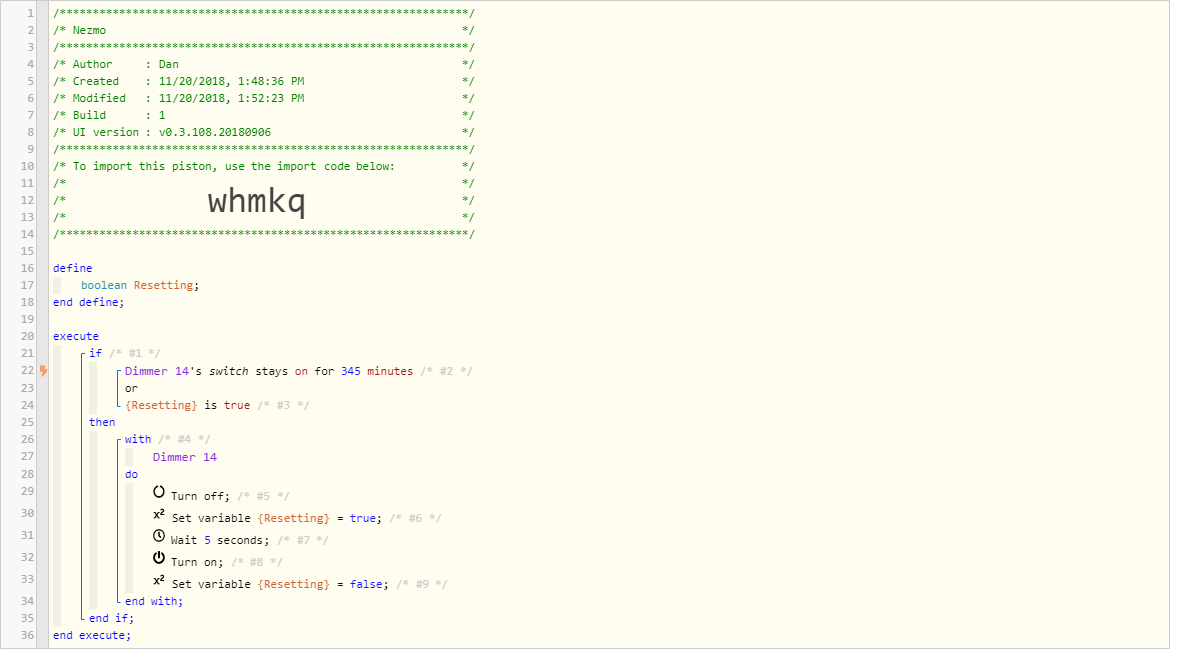

As title suggests I want to cycle a switch off then on after a period of time (to defeat a plugged in fixture’s inbuilt off timer).
If a switch is turned on by any means I want to start a timer for 345 minutes then when that timer runs out turn the switch off then on but only if the switch is still on at the expiry of 345 minutes. Each time the switch is turned on (even if not by this piston) the timer should restart.
I have so far not been able to figure out the ‘only if switch still on’ part which is killing me as I know this should be simple.
