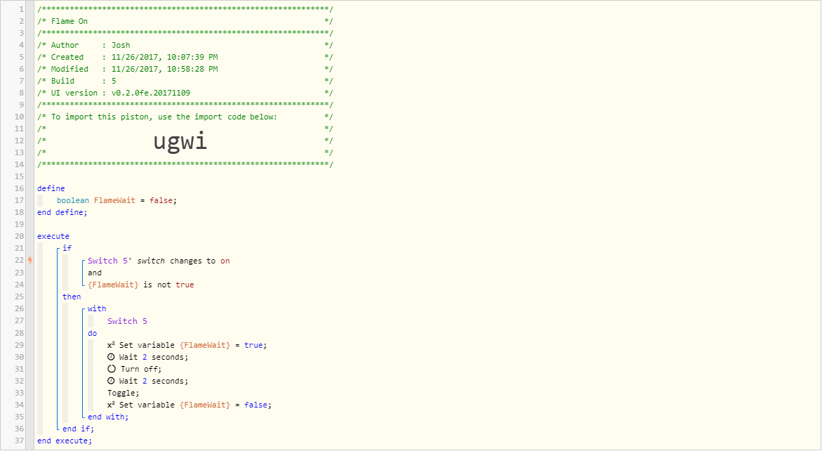

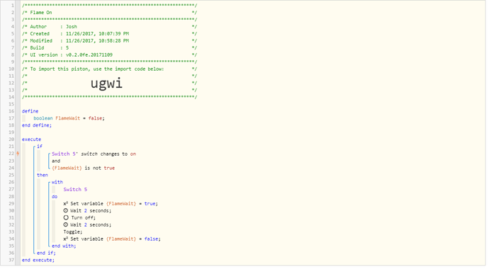

I’ve got a set of lamps with LED bulbs in them. The LED bulbs are either completely illuminated, or display a flame animation. This behavior alternates between each power cycle. Turn it on, and you get flames. Turn it off, then back on, and you get full illumination.
I only want the flames to appear, so I’m trying to build a piston that turns the light off for a couple of seconds and then back on every time a command is sent to turn the lights on, effectively “skipping” the completely illuminated mode of the bulbs. I recognize the potential to accidentally build a recursive loop with something like this, so my piston uses a variable to attempt to avoid that problem.
If a command is sent via any source - or even at the switch - the variable FlameWait is set to “true”, the lights are illuminated for 2 seconds, the lights turn off for two seconds, then the lights turn back on and remain lit. The FlameWait variable is then set to “false.”
When an “on” command is sent, the lights turn on for 2 seconds, then back off, and they stay off.

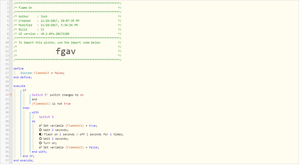

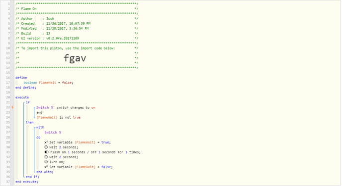

If you can’t work out an approach that works, what if you set a flash sequence with one flash (on/off) and then followed that with a single “on” command?
