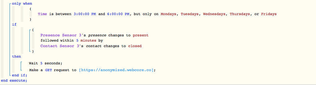

Creating piston based on 2 events with a time stipulation
I want to trigger an event based on my presence changing to present AND shortly after (maybe 10 minutes) a door contact changes to open.

I cant figure out how to put the time part into the piston

You want to use the “Followed By”…
Thanks for your response. I was able to get it done with your help!!
