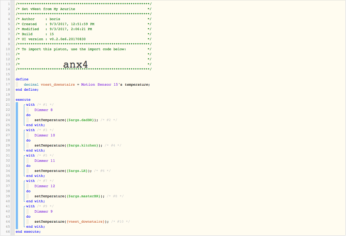

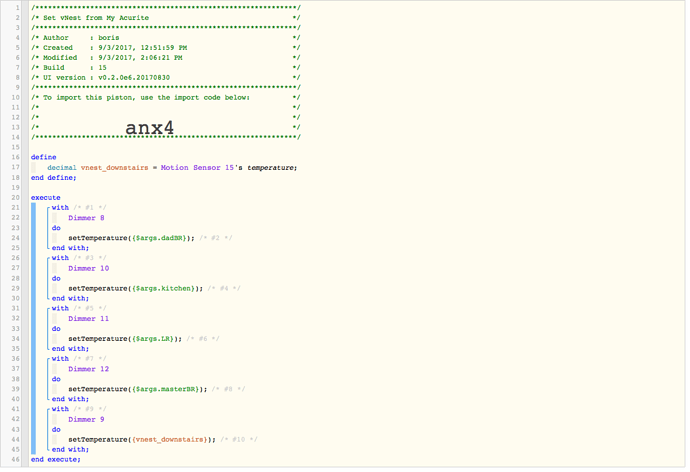

send the results to a webcore piston:
curl -s “https://graph-na02-useast1.api.smartthings.com/api/token/XXXXXXXXXsmartapps/installations/XXXXXXXXX7/execute/:XXXXXXXXX:?dadBR=$dadBR&LR=$LR&kitchen=$kitchen&masterBR=$masterBR”
with the piston below (dimmer should really be simulated temprature sensors)
