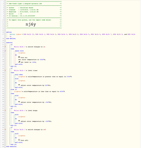

I would like to design a piston that increases the color temp by 500 with each button press if the actual color temp is below 6500 and decreases the color temp by 500 once it hits 6500 down to 2700 then goes back up to 6500. or goes up until it hits 6500 and then goes to 2700 and continues up again.
Please do not take this hard, but I would delete that entire piston, and start fresh…
(it would take a few pages to point out everything)
A button event only needs a single trigger, that has nothing to do with the bulb itself.
Although, your post mentions using a button, it appears your code is using a switch(?).
Which is it? (The coding is VERY different)
It might also make the coding easier if the math balanced out…
Instead of using 500, if you added/subtracted 475 instead, it would take exactly 8 presses to go from 2700-6500. (If 8 presses is too much, you can do it in 5 steps by using +/- 760)
