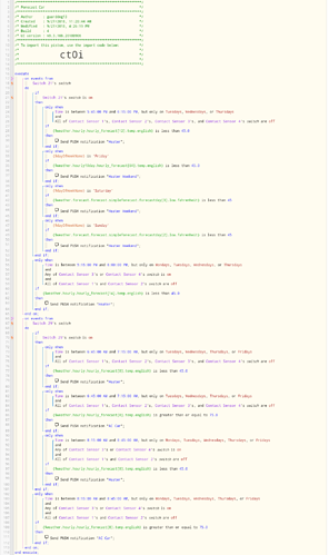

Gopack2

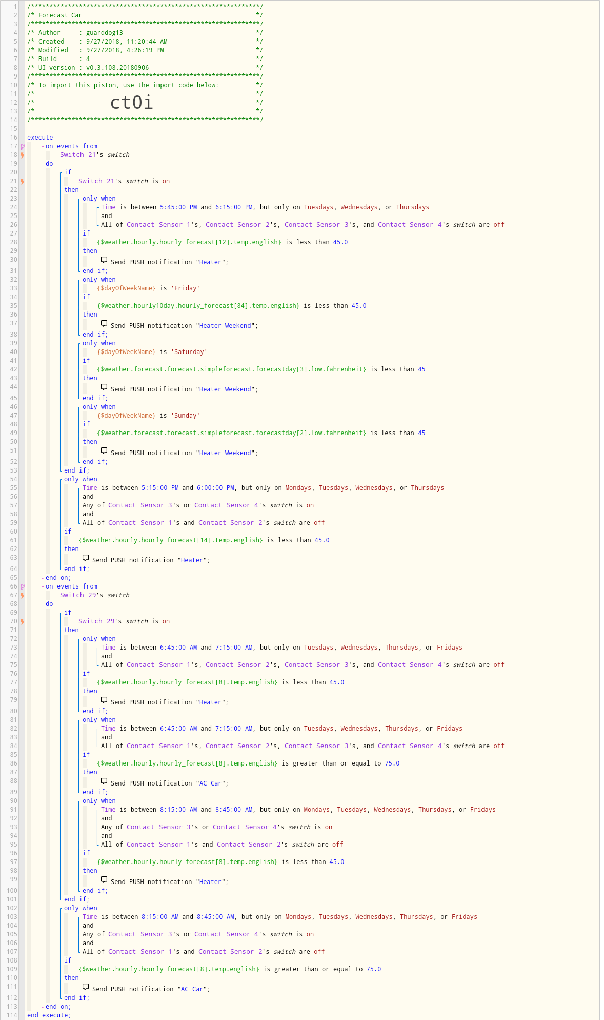

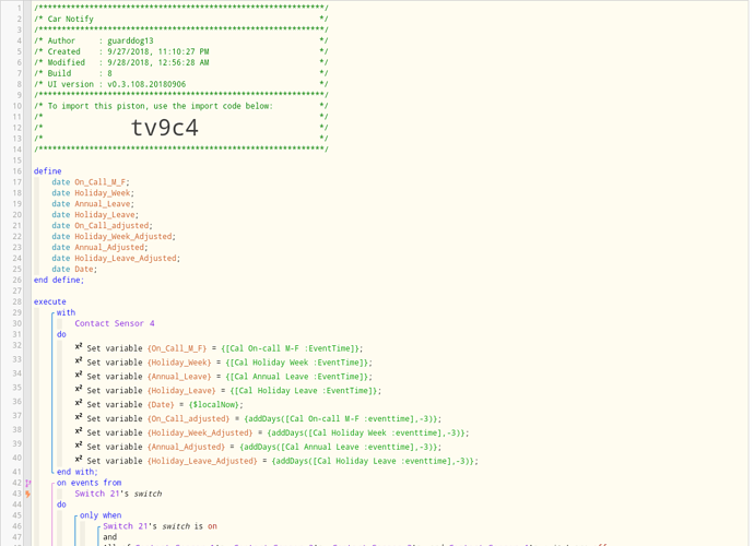

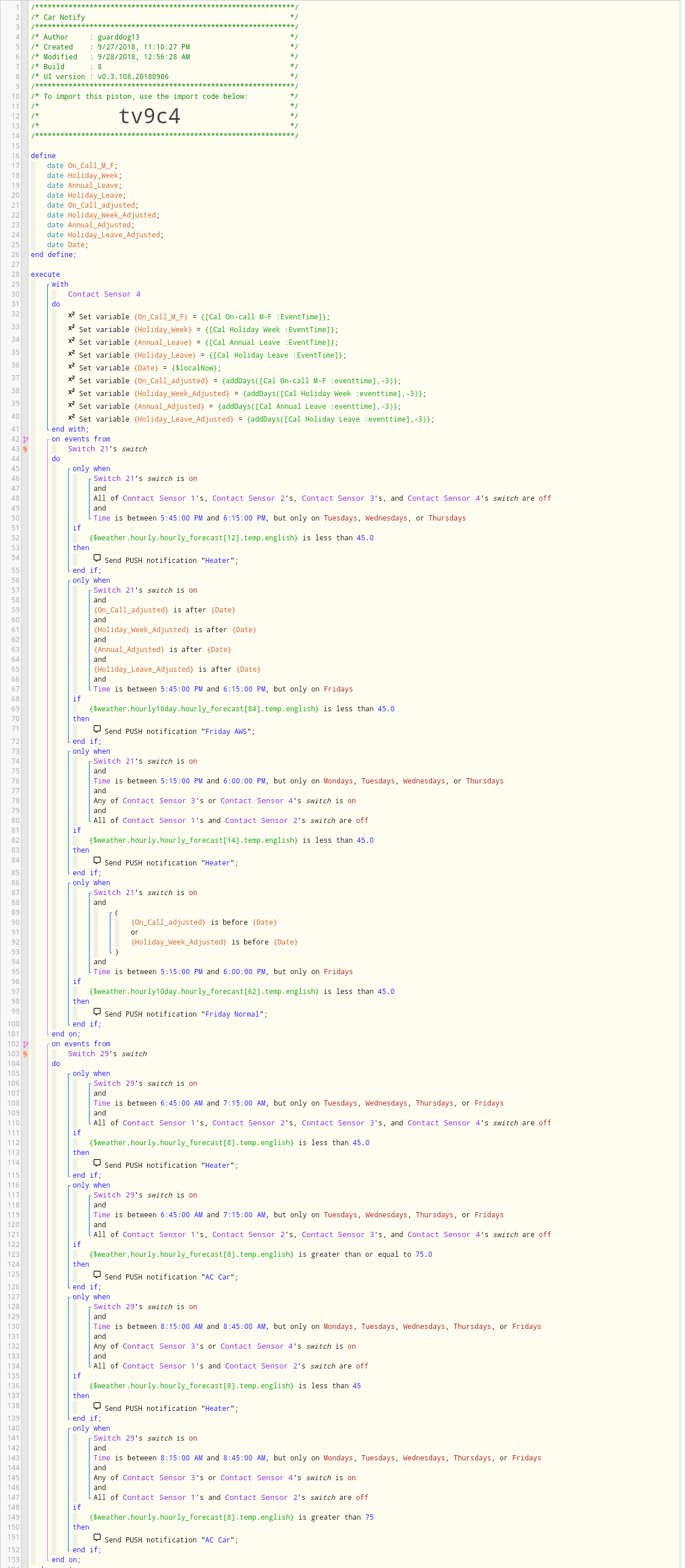

Each push notification sends me a voice message via tasker when I either get home or to work reminding me to set the heater or my ac on my car based on the forecasted high or low. I have a viper smart start system tied into this too.
Yes I have l one each for if I’m on a holiday week, on-call week, annual leave, or holiday leave
Wow, this is pretty good thus far…
However, I would shy away from nesting ifs when possible, they, from my experience tend to act funny at times.
As far as $dayofweekname sections, take a look at the SWITCH options, might be a little easier to do, and maybe a little less code needed…
I’ll play with this tomorrow, I like your thoughts and maybe I can implement something on my end for my use, based on your inspiration.
What do you mean by nesting? I’ve a lot of this with just trial and error and testing with fake switches. I’ve only been on webcore for a week and do not have coding experience so the terminology alludes me. Each of those weather forecasts are based off the hour I would leave for or from work. I have a nice piston for my smart start system. I’ve done most of this on a phone too because my PC is out of order
Well first off, kudos to you for getting that done on a phone… to small of a screen for me😀 and hard to see whole piston on.
When I say nesting, it is where you have a main if statement, then within that if section, you have another if in there.
Try to keep all the ifs at the top level if when possible.

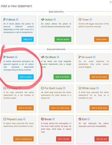

As far as SWITCH options I am referring to this section, instead of using ifs for each day of the week…
Take your time learning… there is tons this can do, and the curve is huge. Keep plugging away. You are doing well for only a week in!
Oh yea typically I don’t do that. I actually don’t know why I did with this one. Thank you I get frustrated often with it because I want to understand it better but a lot of the coding stuff goes over my head
I’ve seen the switch option I just don’t understand how it works. This program is still well beyond CoRE in ease of use

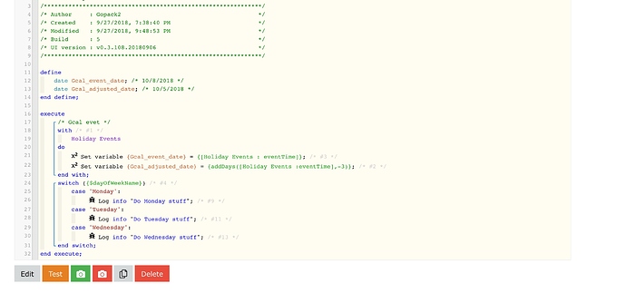

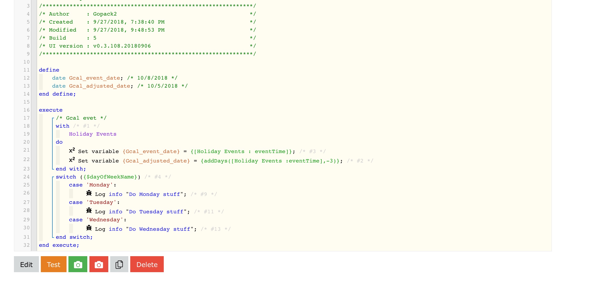

Here is the definition:
https://wiki.webcore.co/Case_Traversal_Policy
To use it, you would use a object for the switch. Let’s say $dayofweekname.
That will return Monday,Tuesday,Wednesday, etc; depending on the day of the week it is ran.
Then each case would have a value set to Monday, Tuesday, Wednesday, etc.
So if today is Monday, it would trigger the Monday actions. Tuesday would trigger the Tuesday actions and so on.
There is also a default case. That would trigger if none of the other cases evaluated as true. So, if you didn’t have a case set up for Thursday, and today is Thursday, then the default case would trigger.
Kind of think of it as an elaborate if/then statement.
I like to use these instead of multiple if / then statements comparing the same object, looking for different variations of the results.
For me it is just easier to read the code and follow, and shortens up some pistons quite a bit.
