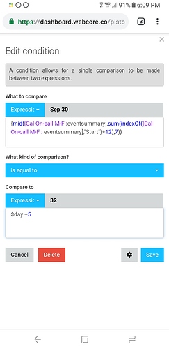

How exactly would I handle this when I’m trying to use gcal to find events at the end of a month? My event falls on Monday but I need it to fire when I get home from work on Friday. $day + doesn’t take into account the month.

I’m sure that’s the answer but it doesn’t help me lol. I have no clue where to set a variable and I’ve been looking.
Ok I figured it out but it’s now giving an invalid datr

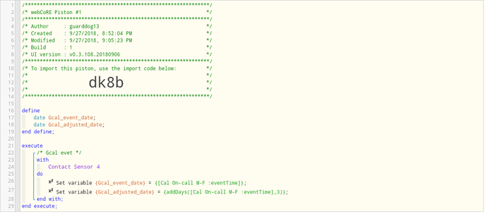

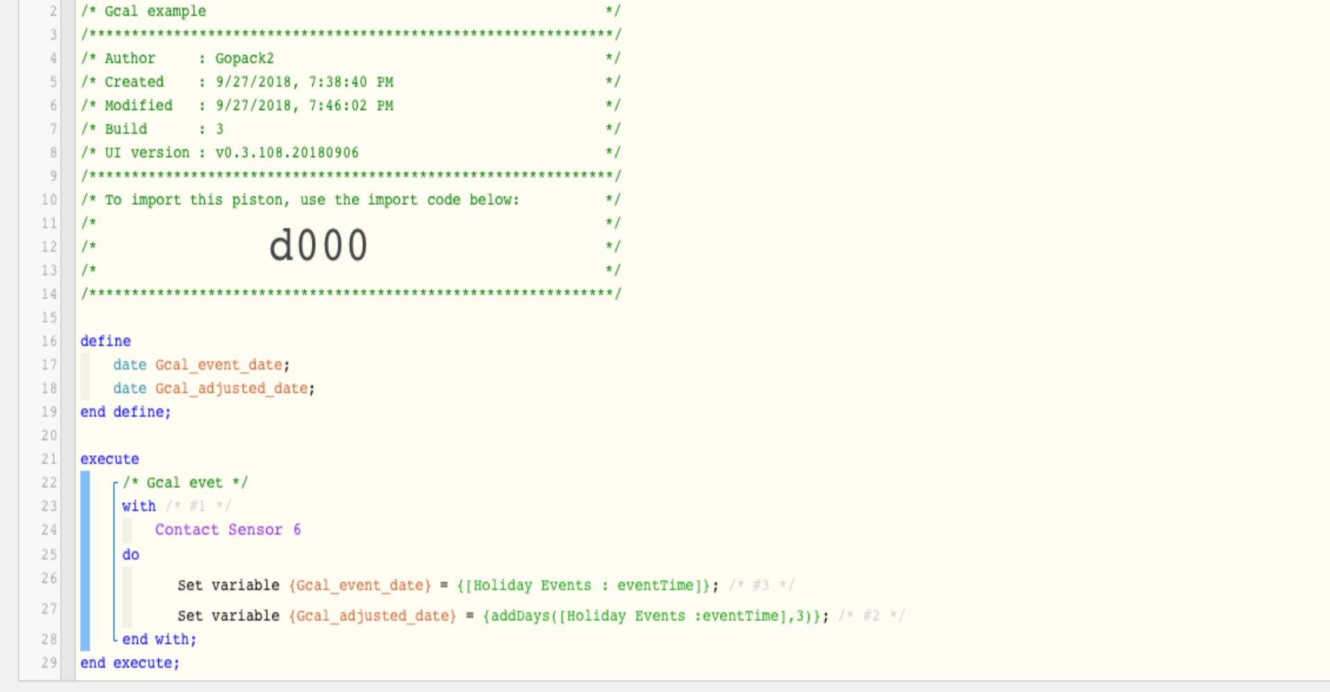

Here ya go…

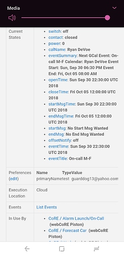

Contact sensor 6 is your Gcal event

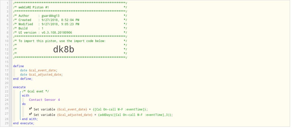

Its returning an invalid date
Can you share your piston?
It’s just the one you sent me with my calendar added. I’m just learning how to use variables ect. I have an idea I want to do based off whether I’m on a normal 5 day work week or 4 day week. On basic pistons this works fine but I’m trying to check the weather forecast on Friday for either Monday or Tuesday based off my calendar on Sunday night
I see what I did

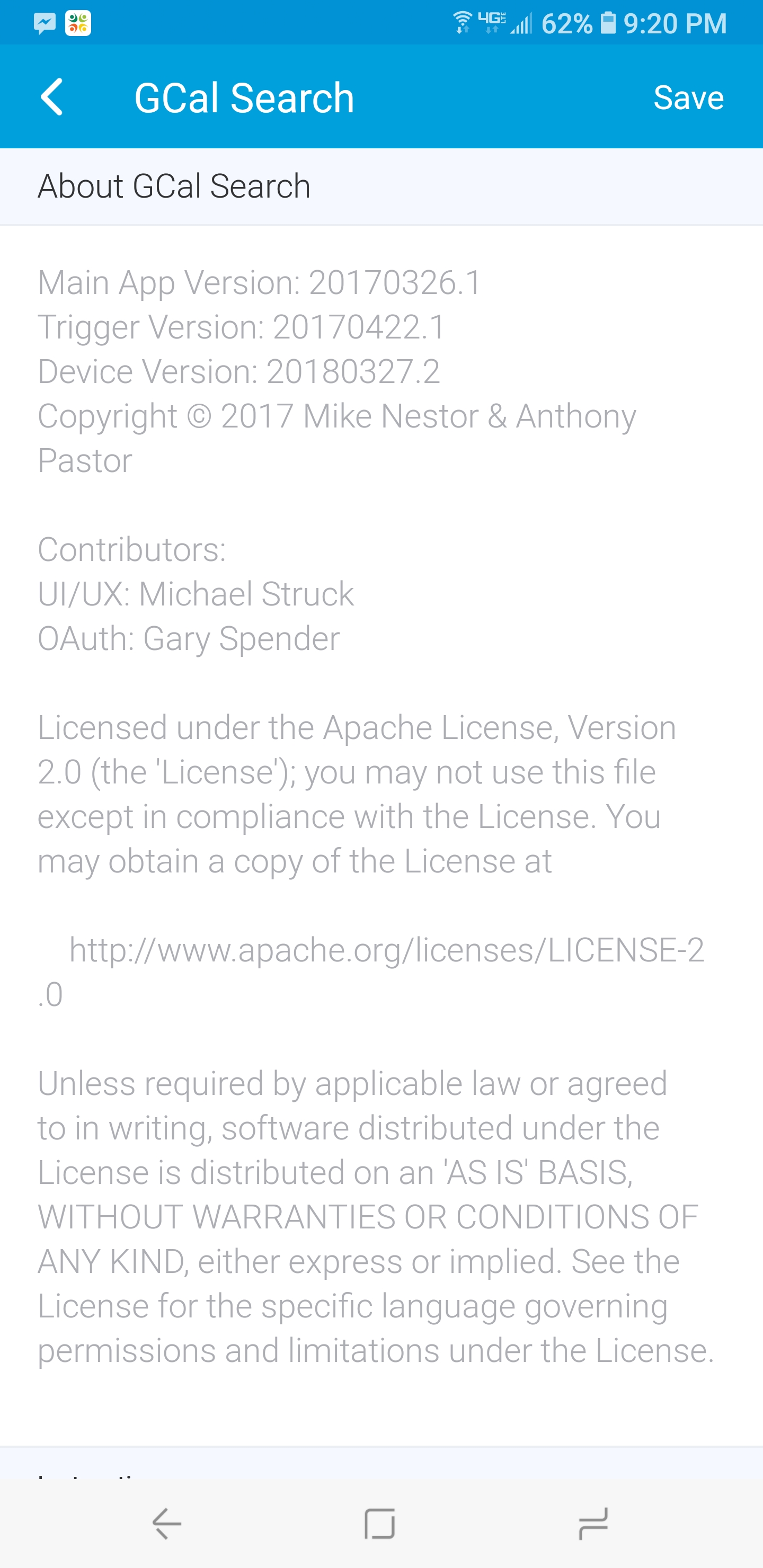

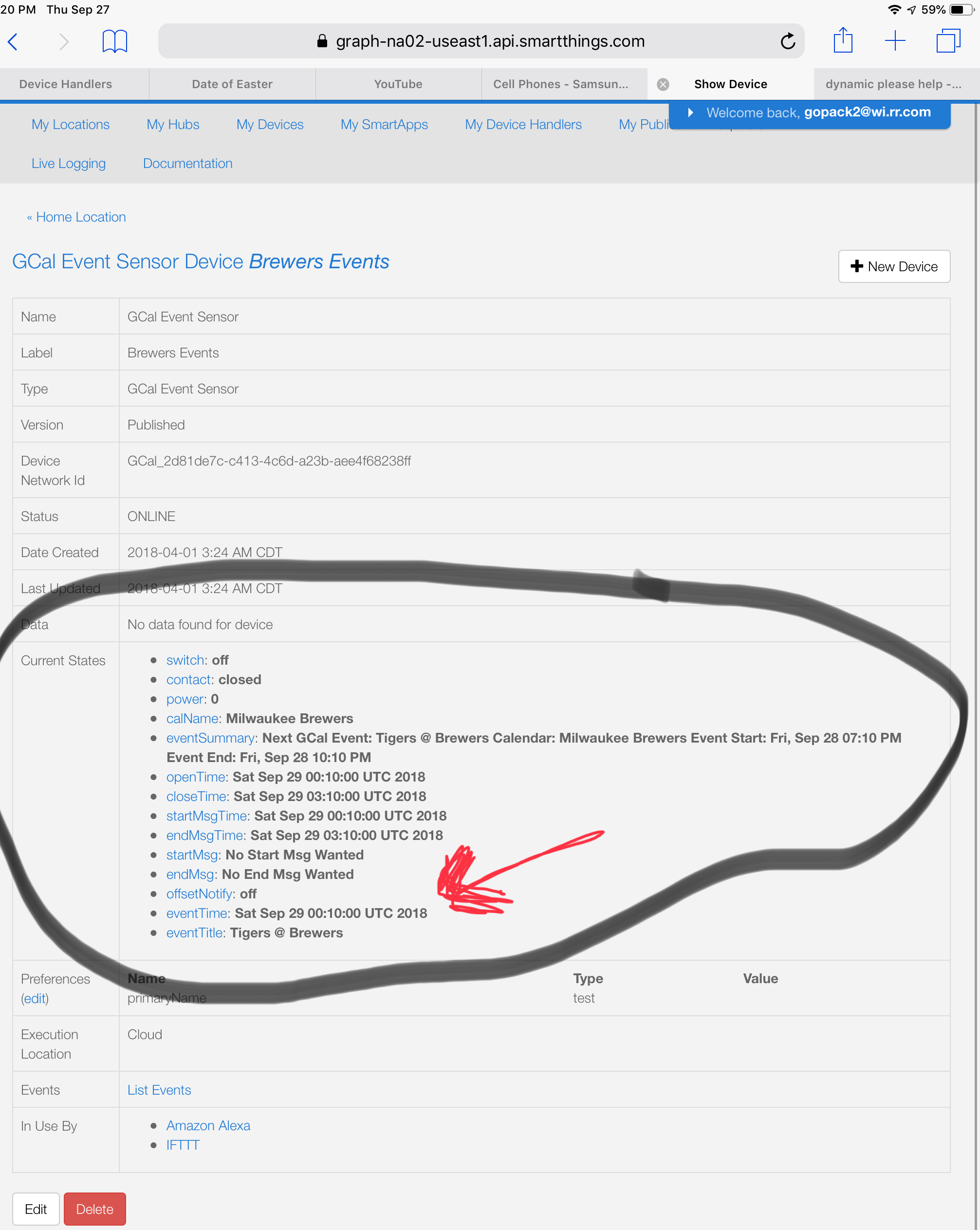

when you look in smartthings ide page. You find the device there called cal on-cal m-f. What attributes does it list? What version of Gcal are you running?
Or not still getting an invalid date
