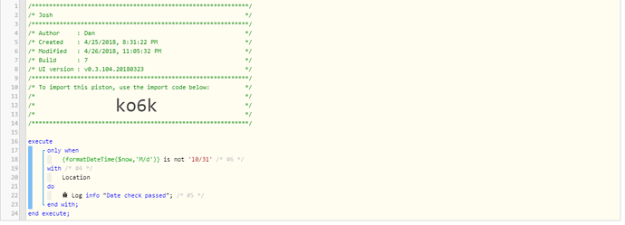

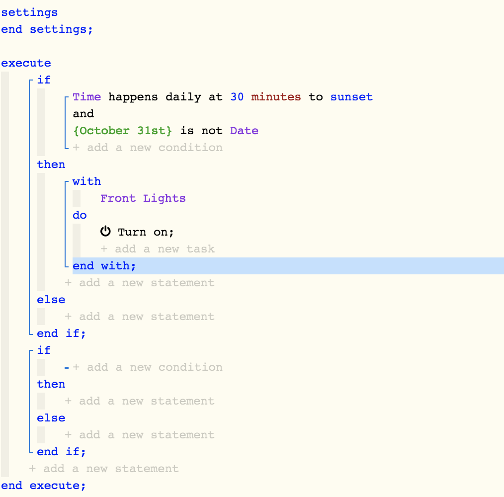

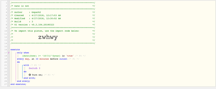

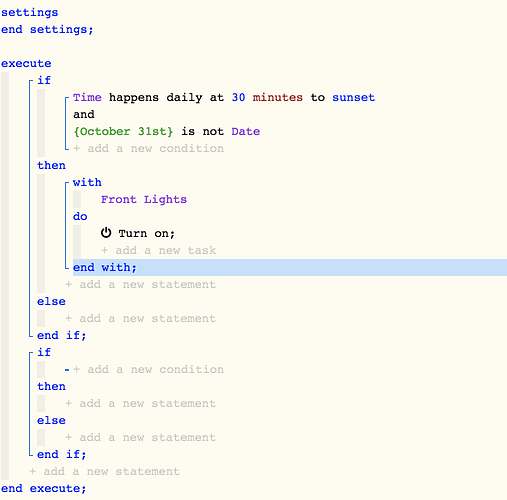

I’m in the process of moving all my pistons from CoRE to webCoRE. I have a piston that turns the lights on the front of the house on each night 30 mins prior to Sunset. I want this to run every night except Oct 31st. (I forget to turn it off and kids come to the door when I’m typically not home).
In CoRE there were restrictions so I had “Only execute when variable matches $currentEventDate is not equal to October 31” When writing in webCoRE I don’t see the option for “Is not equal to”.
Im sure this can be done… I’m just not able to figure it out.
Piston runs everyday except Oct 31 of every year.

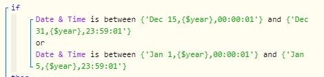

I can add the date but it always requires a year. I don’t want to have to go and adjust it each year.
