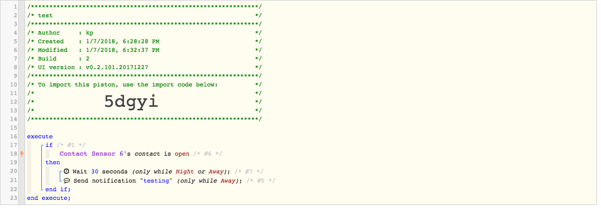

I want a delay so when I return home and my ST is in away mode, i have 30 seconds to change my location once I’ve opened the door.
When a door sensor opens in Away mode, I want a 30 second delay. At the end of the 30 seconds I want a notification sent to me. If the mode changes to Home within the 30 seconds, I want it to do nothing and cancel the notification request.
The first time I tried it, i was it Away mode opened the door. I could see a countdown in the dashboard next to the piston name counting down from 30. It then stoped at 19 seconds and did nothing.
**4) Post a Green Snapshot of the piston!mage|45x37]
Thanks in advance for any help given. I’m new to this so still learning. What I’ve done seems quite simplistic and I have something similar working with motion sensors which is why it has me stumped.
At first glace, the one you’ve asked me to import and previous one I sent look the same. Am I missing something? The only difference I can see are the greyed out letters and numbers after each line of code?
