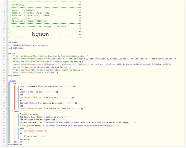

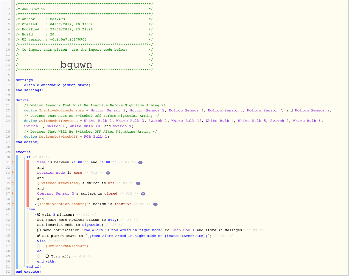

Or you could do something like this. It’s very similar.
This is my nighttime arming piston. You could just modify it slightly to get it to send you the notification you require and do the actions you want too.
Curious why you force subscribed to all of the conditions? What would happen if you just subscribed to time?
I have a habit of always either force subscribing or selecting never subscribe. That way if I ever change a piston or add something new I don’t get a surprise if it stops working correctly because of mixing triggers and conditions and then auto subscriptions would only select the triggers.
Also it means you can still distinguish what is/is not subscribed to in editing mode. (Helpful on very complicated pistons)

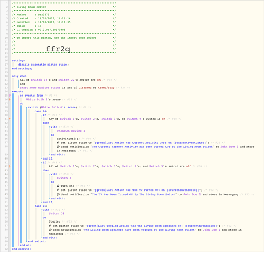

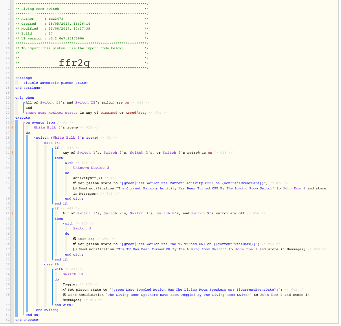

Here is an example.
This piston is a light Switch in my livingroom, it only performs actions based of the scene number from single,double or triple click changes.
So then instead of
"IF the front door contact is closed"
You’d have
"ON event from Front door contact,
If the contact has changed to closed"
