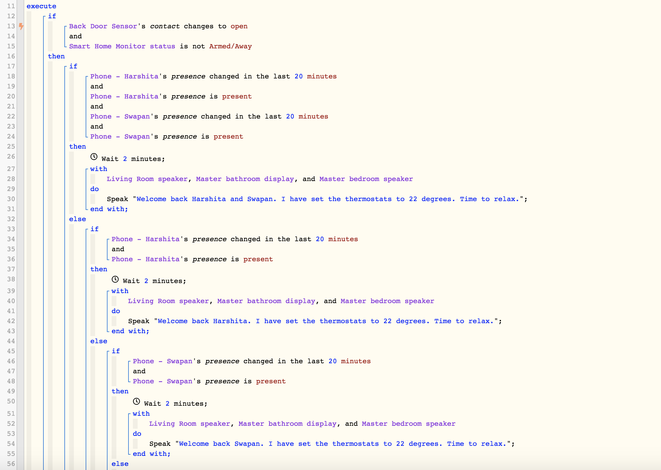

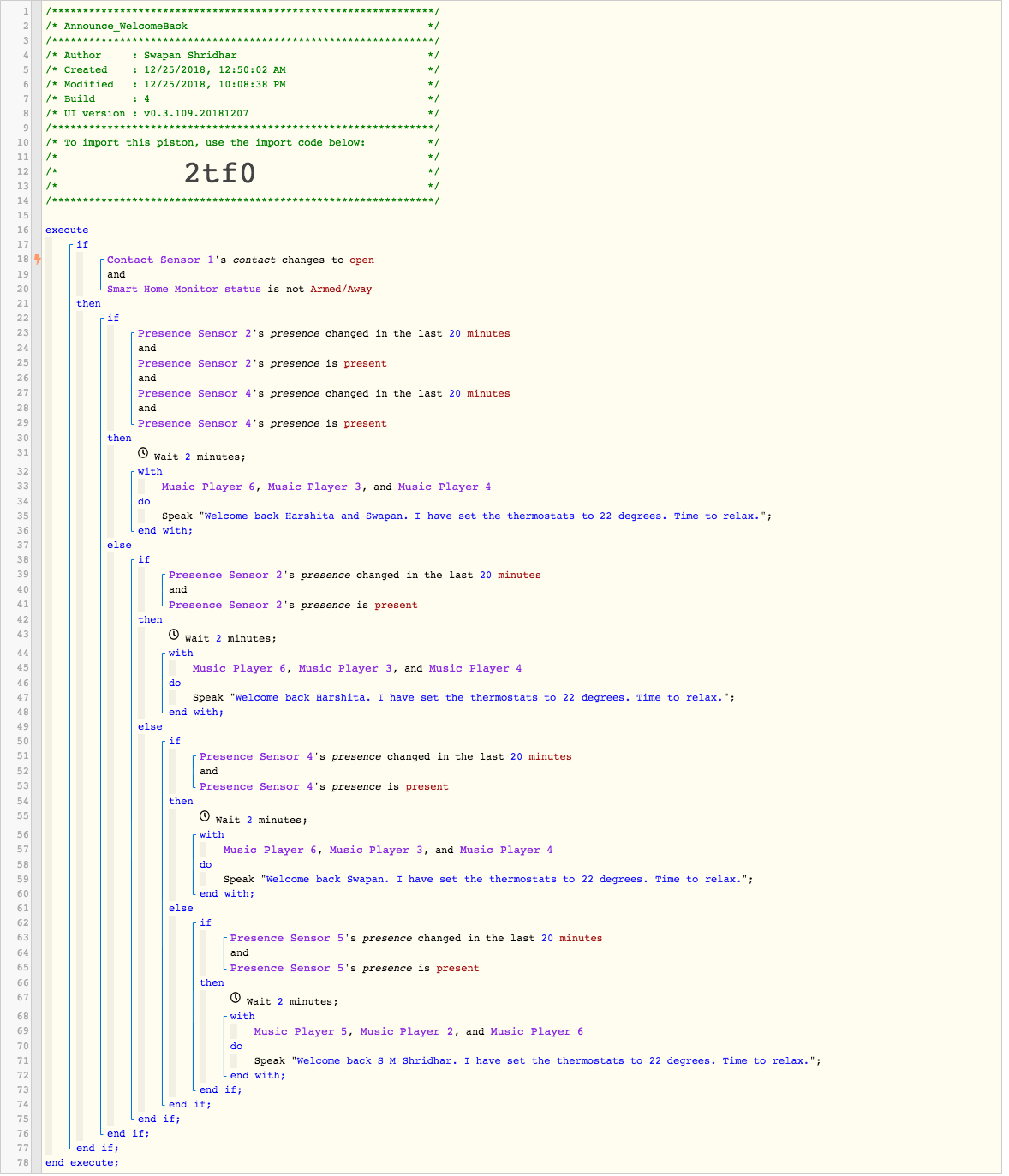

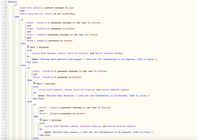

I am writing a Piston where I want to :
- Detect Back Door Opened, AND along with that
- Determine which Phone or Phone(s) were away (away time to be >20 minutes (configurable)) and has now arrived home.
Based on it, do a Google Home announcement.
I am attaching the sample Piston below which I have written, but After multiple tries it hasn’t worked.
Annnouncement/Speak on Google Home, when above criteria is met.
Expected it to do the announcement/Speak on Google Home. Doesn’t happen. Other basic Pistons work. So, the base pipeline of Piston announcing on GHome works.
Above is partial screenshot to tell the if else things I am doing.
