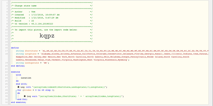

this is what I’ve cobbled together so far…
Set variable {codes} = lock's lockCodes;
for ($index = 1 to lock's maxCodes step 1)
do
    Set variable {x} = {mid(codes,indexOf(codes,$index)+length($index)+3)};
    Set variable {names[$index]} = {left(x,indexOf(x,'"'))};
end for;

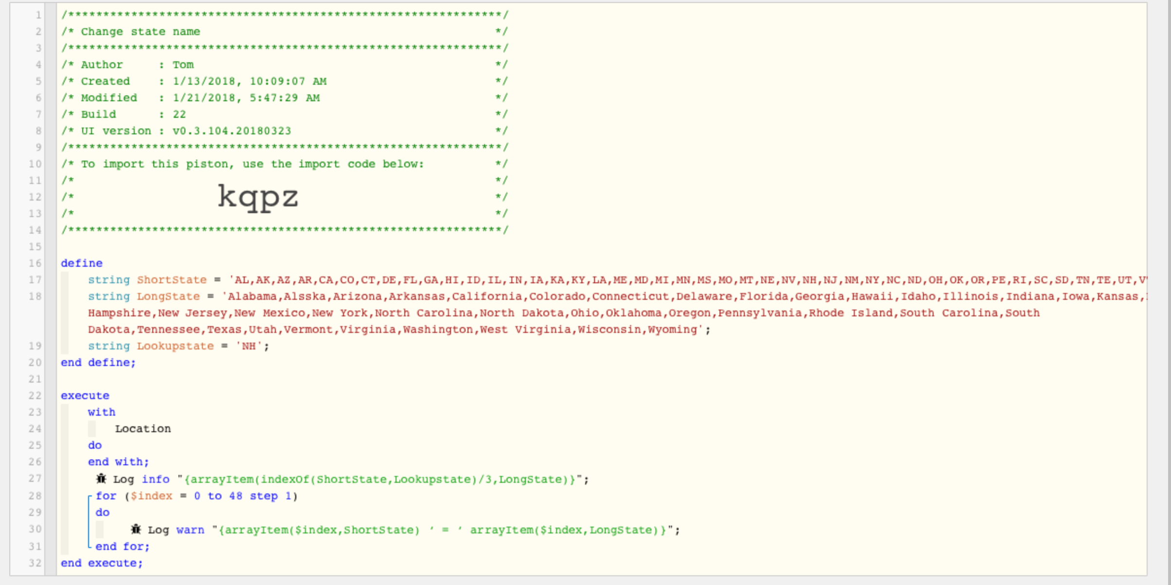

You might be able to adapt this to what you need.
