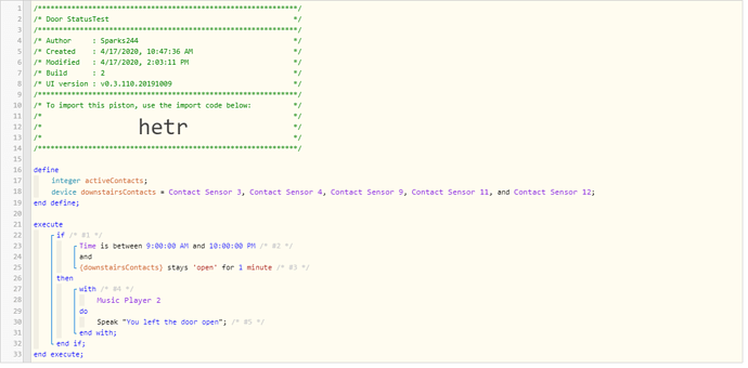

Use a device variable to group common devices and use in piston

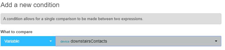

Attributes do not show up as an option when grouped but work properly when used individually
Piston won’t fire to create a log since “contact” is not available
I have read so many threads about issues with device variables and many with this same issue but I have yet to read about a solution. Perhaps I missed it, and in that case, maybe someone could direct me to the thread with an answer.

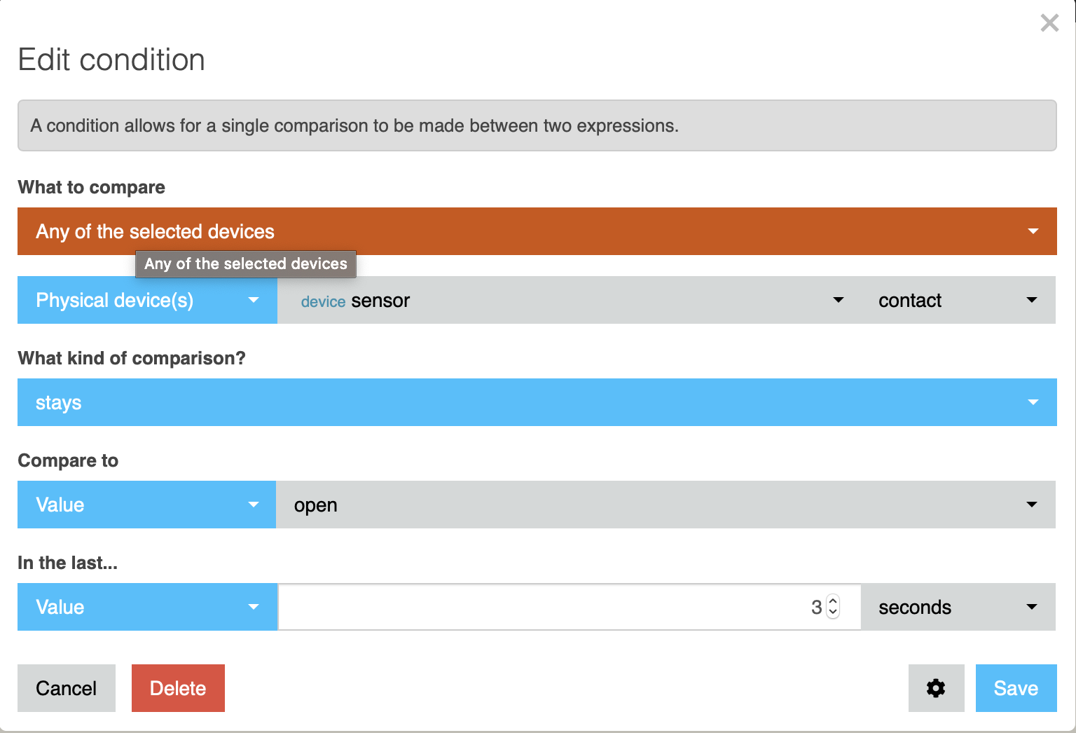

Your issue is you don’t want to compare a variable. The variable only contains the device, not the contact value. You need to select physical device and then scroll down to your variables and select ‘downstairsContacts’. Then you will be able to select ‘contact’. see below (sensor is a Device type variable).
Thank you @guxdude. I’m still learning and appreciate the help.
