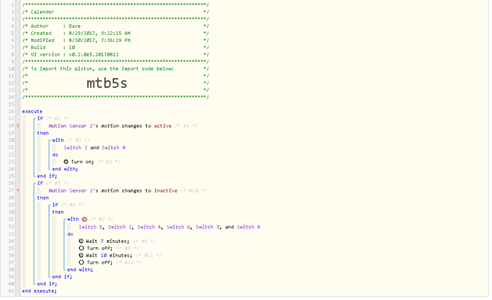

Hello, I wrote this code. when i walk in my kitchen I want my undercabinent lights to turn on and a computer moniter running DAKboard to turn on. This always works. Sometimes we turn the kitchen lights on but sometimesthe undercabinent is sufficient. in the case that the kitchen lights are all on I want those to turn off when there is no motion. Now I am using TP link wifi switches because thats what i had installed. I am using the TP-Link connect smart app which polls the switches to see if they are on every 15 min. I set 2 turn off commands because i think if it is busy polling the switchs it will not turn them off. But one of them is a Z wave switch. that also doesn’t turn off all the time. I turn the switches on with alexa through smart things. so as soon as they turn on smart things knows and shouldn’t have to wait 15 minutes to poll Here is the logs and my script. I might not be around a computer to reply untill Friday morning hopefully someone can help.
Thanks

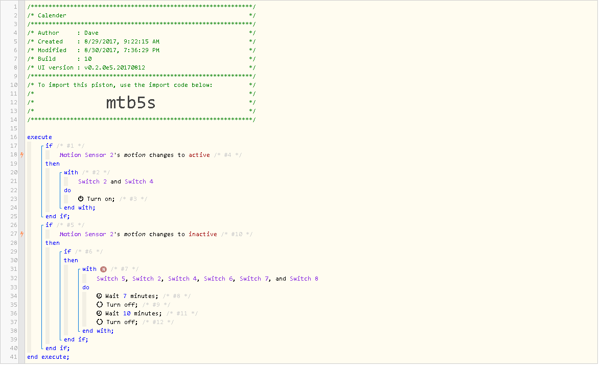

at line 29 there is an extra if which is why the lights are not turning off. starting at line 26 it looks like this:
if motion sensor 2 motion changes to inactive
   if
      with switch 5, 2, 4, 6, 7 & 8
         wait 7 mins
         turn off
         wait 10 mins
         turn off
      end with
   end if
end if
it should look like this:
         wait 10 mins
         turn off
      end with
end if
Didnt even see that. Thanks
sure.
