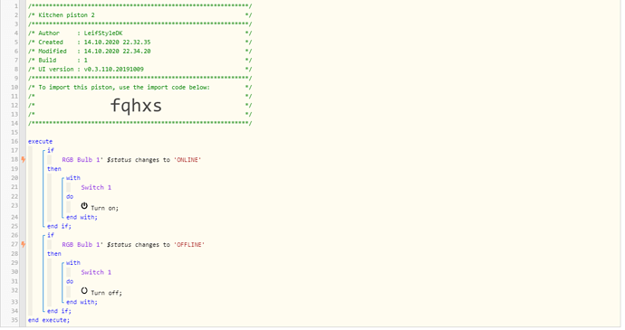

One of my pistons controlling a smart socket have stopped working since of october 5th.
I suspect it could have something to do with the parameter DeviceWatch-DeviceStatus under “Current States” in SmartThings IDE not being updated. When hovering that parameter in any of my connected units, that parameter hasn’t been updated since before Oct. 5th.
The DeviceWatch-DeviceStatus parameter is supposed to hold information about the units current state - offline or online. In my piston I use an IF to check for DeviceWatch-DeviceStatus if the light in my kitchen is changed to offline (turned OFF on the wall switch) or changed to online (turned ON on the wall switch). If changed to offline/online, do this or that.
Nothing is happening. It’s like the piston doesn’t get or catch that information when the state changes. The state doesn’t change in SmartThings IDE either.

5.10.2020 14.46.57 +658ms
+1ms ╔Received event [Køkkenbord lys].DeviceWatch-DeviceStatus = online with a delay of 44ms
+69ms ║RunTime Analysis CS > 21ms > PS > 4ms > PE > 45ms > CE
+72ms ║Runtime (37109 bytes) successfully initialized in 4ms (v0.3.110.20191009) (70ms)
+80ms ║║Comparison (string) online changes_to (string) online = true (1ms)
+82ms ║║Cancelling condition #2's schedules...
+83ms ║║Condition #2 evaluated true (6ms)
+84ms ║║Cancelling condition #1's schedules...
+85ms ║║Condition group #1 evaluated true (state changed) (8ms)
+87ms ║║Cancelling statement #7's schedules...
+104ms ║║Executed physical command [Elkedel].on() (14ms)
+105ms ║║Executed [Elkedel].on (16ms)
+111ms ║║Comparison (string) online changes_to (string) offline = false (1ms)
+113ms ║║Cancelling condition #4's schedules...
+114ms ║║Condition #4 evaluated false (6ms)
+115ms ║║Cancelling condition #3's schedules...
+116ms ║║Condition group #3 evaluated false (state changed) (8ms)
+118ms ║╚Execution stage complete. (46ms)
+119ms ╚Event processed successfully (119ms)
5.10.2020 07.36.22 +940ms
+1ms ╔Received event [Køkkenbord lys].DeviceWatch-DeviceStatus = offline with a delay of 55ms
+96ms ║RunTime Analysis CS > 26ms > PS > 4ms > PE > 65ms > CE
+98ms ║Runtime (37112 bytes) successfully initialized in 4ms (v0.3.110.20191009) (96ms)
+108ms ║║Comparison (string) offline changes_to (string) online = false (0ms)
+109ms ║║Cancelling condition #2's schedules...
+110ms ║║Condition #2 evaluated false (6ms)
+112ms ║║Cancelling condition #1's schedules...
+113ms ║║Condition group #1 evaluated false (state changed) (8ms)
+119ms ║║Comparison (string) offline changes_to (string) offline = true (0ms)
+120ms ║║Cancelling condition #4's schedules...
+121ms ║║Condition #4 evaluated true (6ms)
+122ms ║║Cancelling condition #3's schedules...
+123ms ║║Condition group #3 evaluated true (state changed) (8ms)
+126ms ║║Cancelling statement #5's schedules...
+153ms ║║Executed physical command [Elkedel].off() (22ms)
+154ms ║║Executed [Elkedel].off (24ms)
+157ms ║╚Execution stage complete. (58ms)
+158ms ╚Event processed successfully (158ms)
