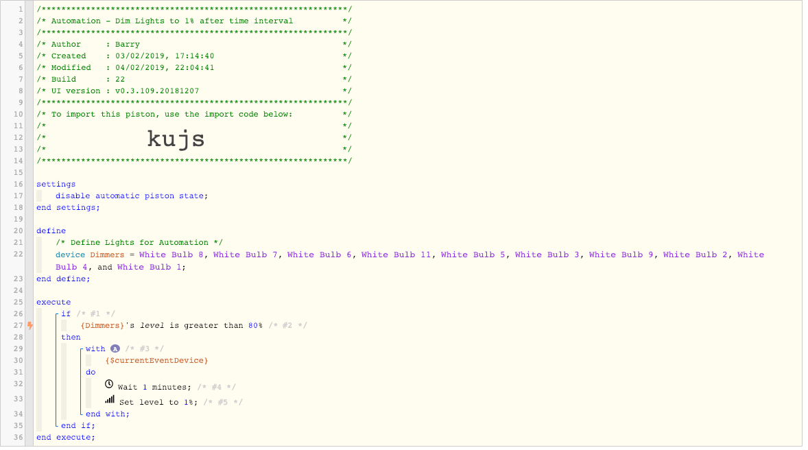

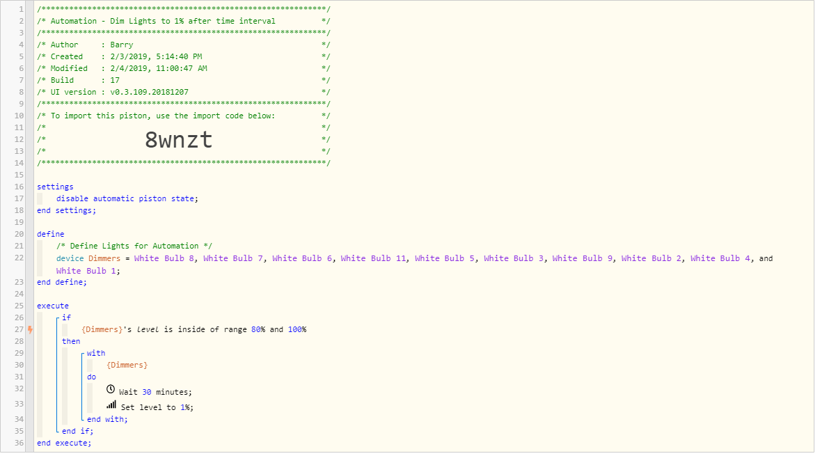

To build a primary dimmer automation for all my Fibaro 212 dimmers, currently my switches are configured on double click to set light brightness to 100% I would like a simple consolidated piston to dim light back to 1% after 30 mins, due to my lack of programming back ground I am struggling with the basics, currently this works great but if I go into another room double click another switch timer resets and will dim both lights concurrently together after new wait time.
like to avoid creating a separate piston for each device.
I would like each light to have a separate timer to dim on its own timed schedule running in one piston.
working fine / but when I have a timer running for 1 dimmer and I double click another switch timer resets and dims both together at end of time limit.

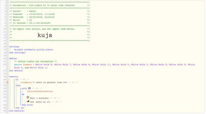

been doing some work figured it out finally :smile: seems to be working for me now.
