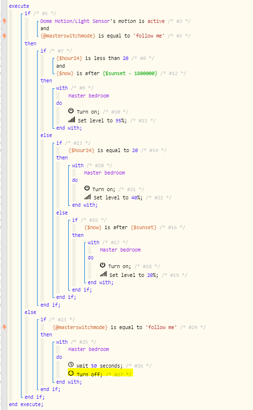

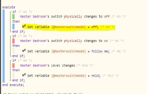

I have a piston to turn off a light after motion has cleared. When the piston programmatically turns off the switch, another piston turns off the motion sensor as though the switch was physically turned off.
Do not turn off “follow me” mode when switch turned off programmatically.
Turning off “follow me” mode when switch turned off programmatically.
First Piston:
Second Piston:
Master switch mode is turning to off when turned off programmatically.
