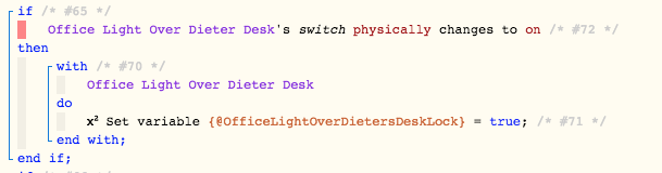

I have GE zwave dimmer switches all over my house. in webcore, i am trying to set up a variable to lock the light on if it is physically turned on ONLY. The option is there on webcore, but it can’t discriminate between a physical interaction and a programatic interaction
being able to program different behavior depending on physical versus programatic
regardless of whether the switch is physically turned on or it is done through smartthings etc, it looks the same to the program
any help on tihs is appreciated. perhaps there is a device handler problem???
