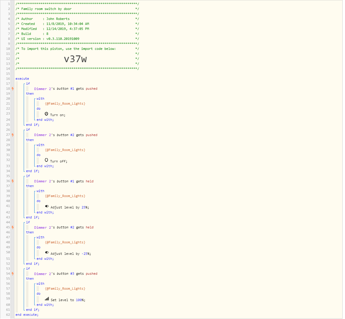

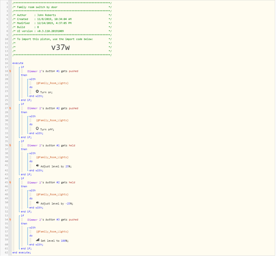

I wrote a piston to control my family room lights using scene control with a Zooz Zen27 dimmer switch. Switch has relay disabled to push constant power to 6 smart bulbs, so I’m using the scene control functions to control the bulbs.
Hold button one (push and hold switch up) increases brightness - Hold button two (push and hold switch down) decreases brightness.
It appears as though Webcore is not recognizing the “held” state. The logs below show the push up to turn on lights, then miss two “held” events trying to dim the lights, and then registers the push down to shut the lights back off.
There is a held state command for scene control. It works if I set up the same control configuration using ABC Button Controller. However, I want to use Webcore for ease of modifications, and ease of duplicating the piston for use in other rooms.
These commands do nothing. The other commands in the piston work as expected.
