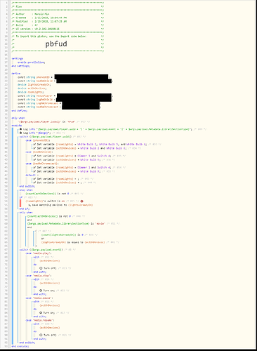

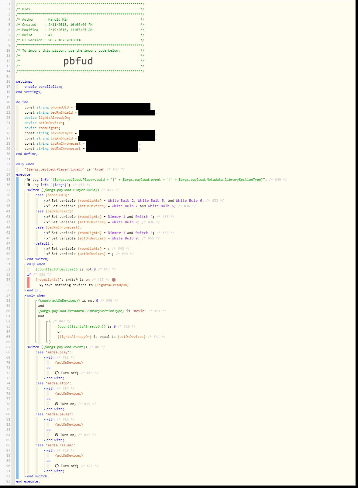

webhook should trigger the piston
Since the webhook errors, the piston does not even attempt to run.
It’s not really complete since a key event is not triggering, but it should give you an idea.
