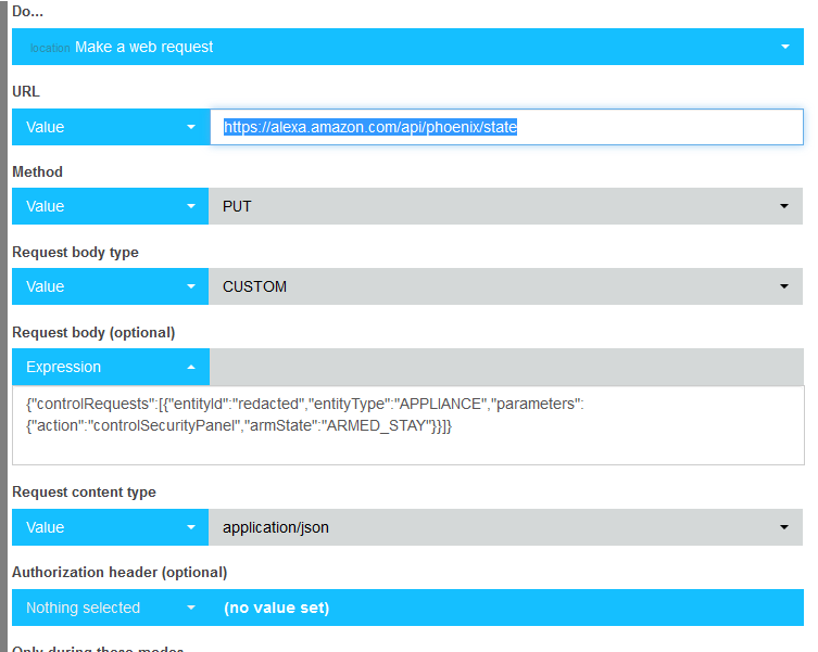

Unable to figure out how to code the PUT request
Here’s what I have so far
No logs yet, haven’t been able to develop
Not sure how to figure out my entity ID, or configure the Alexa API login/authentication. Thanks for any thoughts on this
