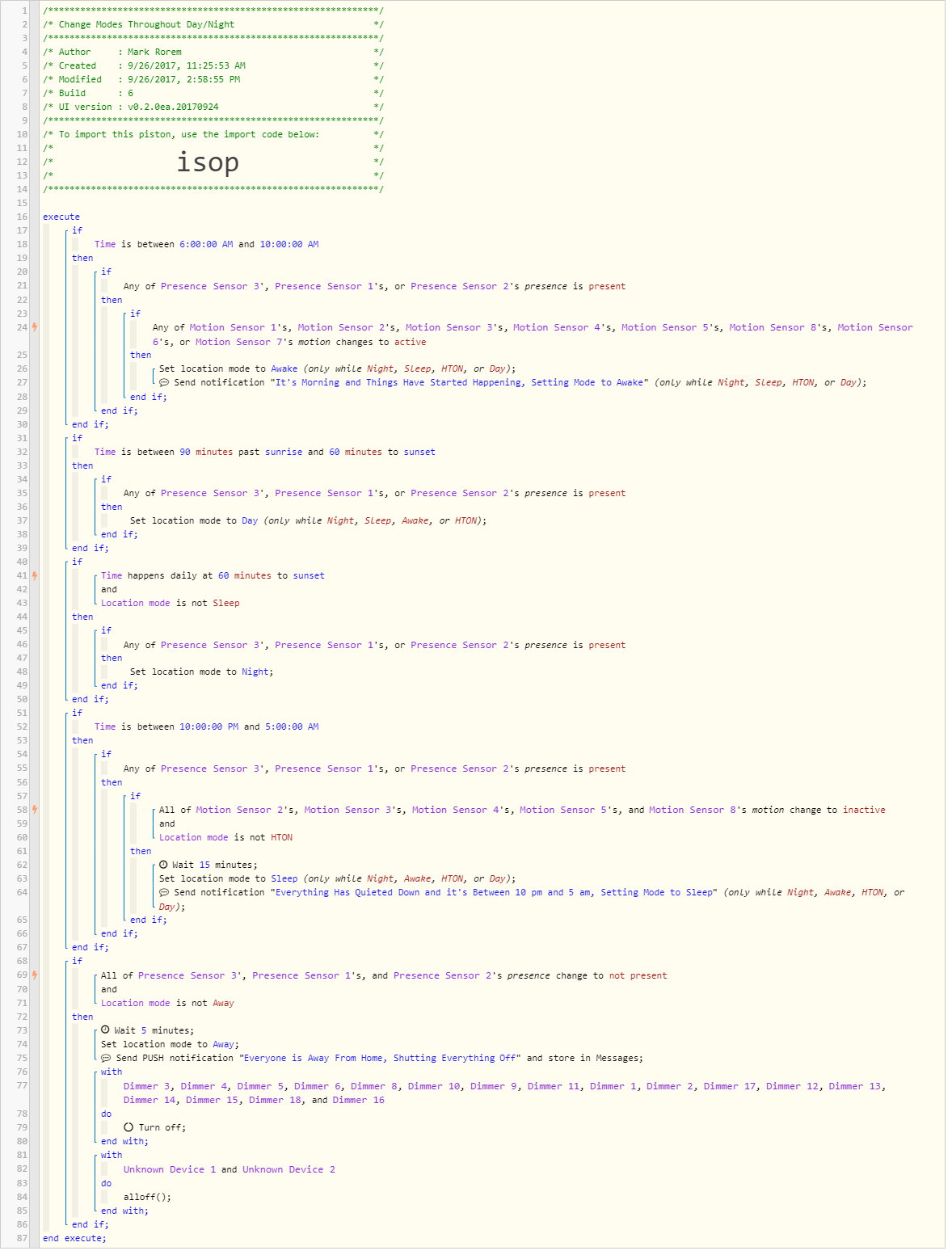

I borrowed and tweaked this location mode piston from “House Scheduler” on Advanced Pistons Example page. When comparing my piston to the example I see that OA is setting the “subscription method” on each of the “prescence ifs”. What is the purpose of this and should I be using that in my modified version?
Works as written, but I’m not sure if it’s running optimally
Occasional “piston waited at a semaphore for xxx ms”
