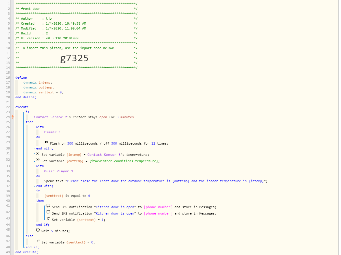

want to understand if I can combine all my door sensor pistons into a single one. I’ve attached one that I have of 4…
I want to put all my door sensor pistons together and have a foreach loop of all door contacts
My piston has a 5 min wait after notifying that a door is open …and I’m trying to understand if that 5 min wait would hold off the foreach loop from going to the next sensor
not there yet
not there yet
Why do you have a 5-min wait?
I suspect that you don’t want to hear the “Close the front door” message more than once per 5 minutes. Is that the case?
With the current settings you have, the piston will be restarted each time that condition (the lightning bolt line #24) is met. There are some settings that control how that works, but I’m not an expert with that yet. Instead, I might try setting senttext to a datetime expression of addMinutes($now, 5), then check if $now is greater than senttext in line 39.
For the other part of your question (while loop), I do something similar with my “alarm” piston, but I think @WCmore says that you shouldn’t subscribe to so many devices in a single piston. It did seem to work, aside from the app sometimes not noticing that I was at home.
If the temperature is your biggest concern, I would make that a starting condition. Otherwise, it’s going to give the warning whenever the door is open regardless.
If so, you might want to designate a range (+/- 5 or 10 degrees). Otherwise, you’ll hear a warning even if there’s only a 1-degree difference.
Thanks for the responses !
Mebejedi and ian_boje
The goal was to notify you when the door was left open…then wait 5 mins before notifying again
My question revolves around the fact that I have 4 separate pistons doing the same thing and was wondering if a for each device would act the same as 4 separate pistons or would get hung up on the 5 min wait

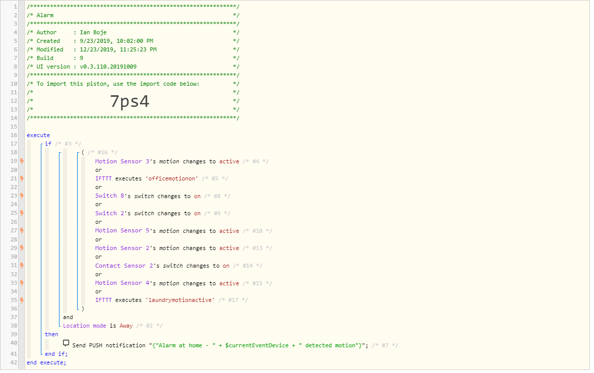

While I believe, for all practical purposes, this is true… your 7ps4 piston might actually be a valid exception.
pic

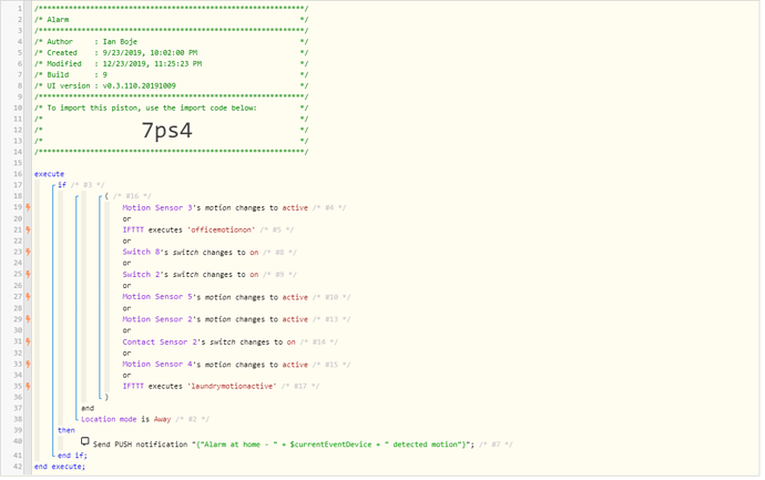

My logic is, the entire code base is a single line (line 40). This means it completes the piston a few milliseconds after it begins… 99.9% of the time, there will only be one “version” of the piston in action at any given moment. (this is good)
One of the reasons why I traditionally discourage multiple triggers is because most pistons grow in complexity, and it takes longer to process the extra lines of code. This means walking normally thru your house, Sensor 2 may trigger, and while it is still processing (or waiting etc), then Sensor 4 triggers. (this can really complexify your troubleshooting and coding)
If I am remembering correctly from another thread, it is also worth mentioning that @ian_boje’s piston is normally Paused, so not competing with other resources.

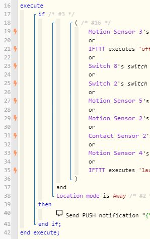

Edit:
I just noticed line 38… “IF Location is Away”.
If this piston is left running 24/7, then it will trigger at each event, all day, every day… even while you are home. (thankfully the code to execute is super quick)
While this is true, wouldn’t it save some cycles if line 38 was before all the checks? If Location is home, it won’t bother with the rest. Not a huge deal, but…
It won’t make any difference… A condition is not checked until after a trigger fires.
