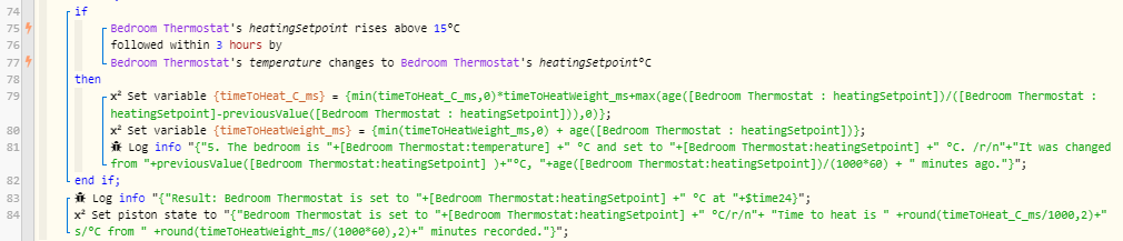

Does anyone have a good "time to temperature" piston?
temperature
time
I’m looking to build a predictive logging piston to calculate the time it will take to heat a room. I have one built and testing, but I’m wondering if there’s a “better” way. this is built into my thermostat scheduler, and will eventually be used to predict when to change the thermostat.
Progressively updating the time to temperature calculations and weighting it as more data comes in

Unfortunately, this model is bare-bones (StelPro line), and you have to create any schedules externally. If I can use a simple timeToTemperature function to predict how long it will take to heat up my room, and I know that I go to bed at the same time and wake-up at the same time most days, it should be easy enough to time perfectly…
I’ll report back once I have enough data points to know this is working. The bug in the code above is that the thermostat reports setpoint temperature changes in increments, so my change in temperature is always 0.5 C.
