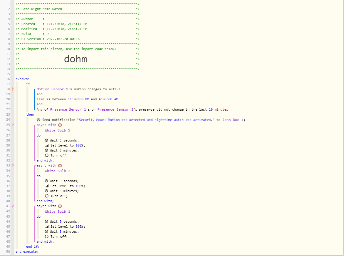

I’m trying to accomplish this piston ONLY firing IF my presence sensor or my wife’s hasn’t changed in the last 10 minutes. Last night she came home and the routine ran when I expected it shouldn’t have. Could use some help here, thanks in advance.
Without logs it’s hard to tell but she probably tripped motion before her presence reported present… therefore her presence had not changed since she left.
Alright, I’ll turn on logging and go from there. Thanks for taking a look Robin!
