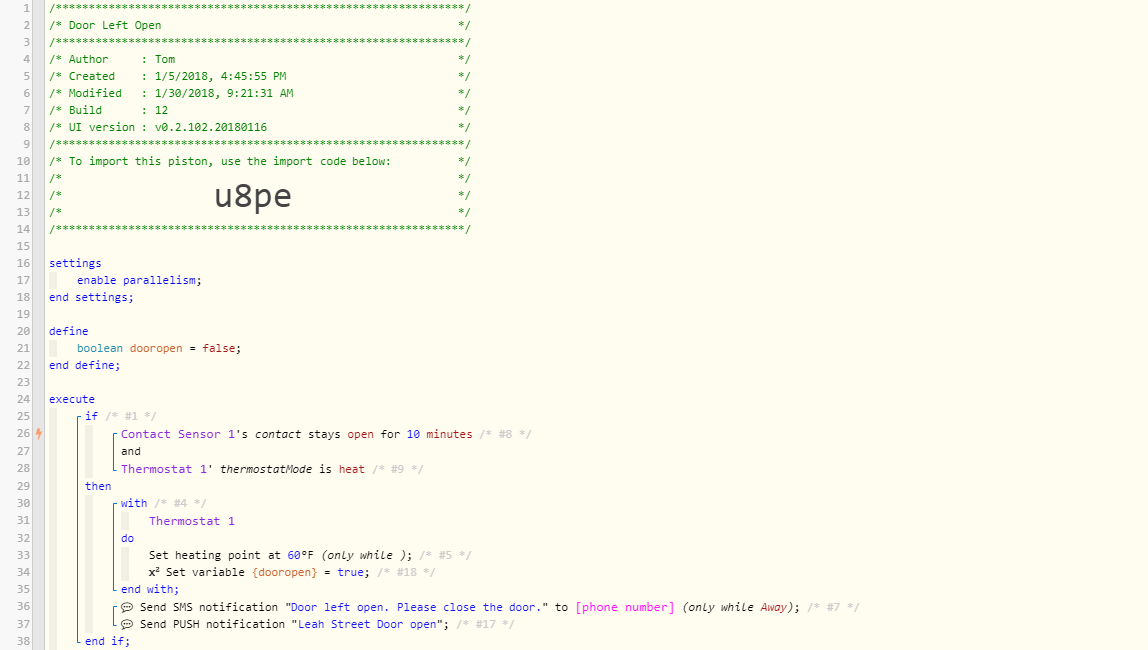

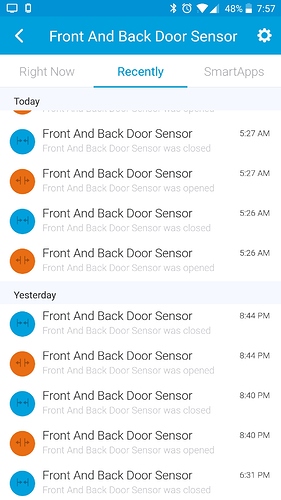

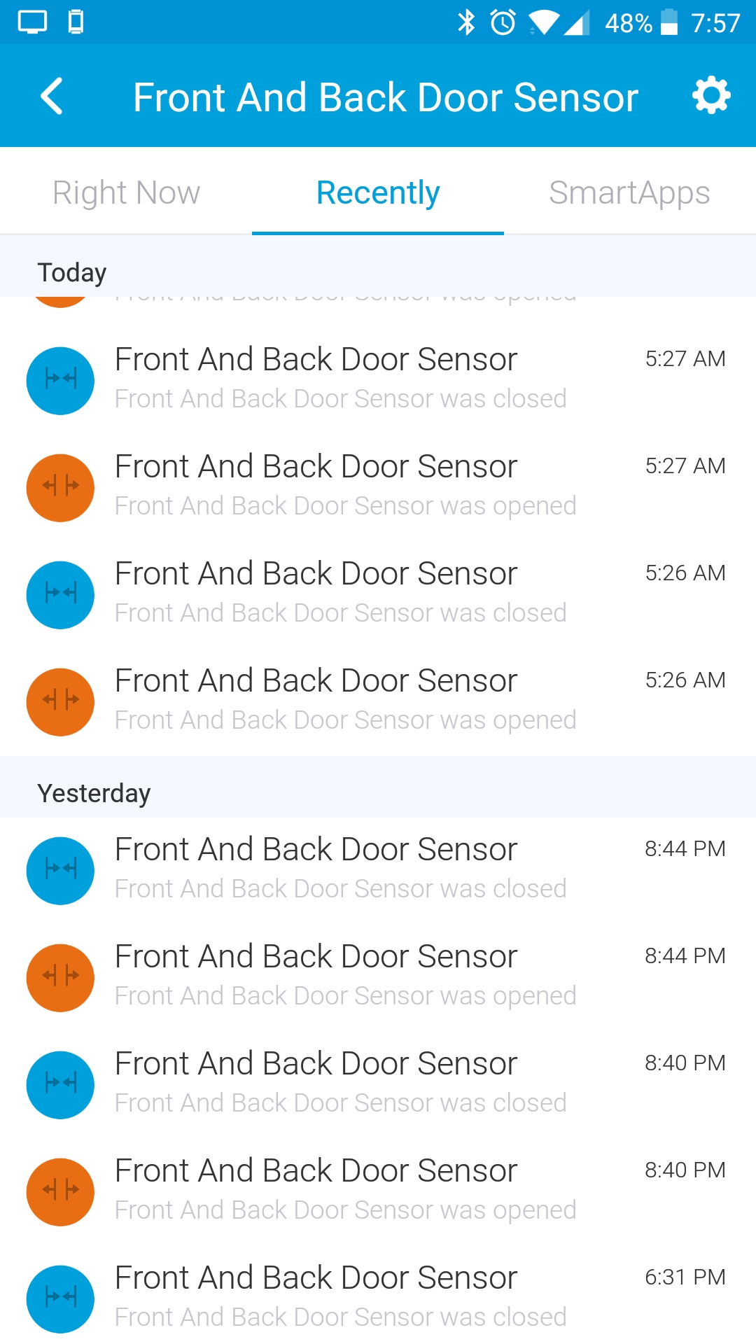

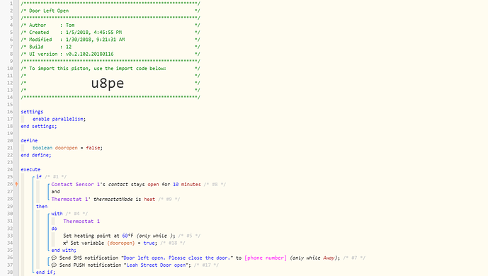

My door sensor sent off two open closed events back to back. In smartthings log it is OPEN, CLOSED, OPEN, CLOSED. In my webcore logs it’s OPEN,CLOSED, CLOSED, OPEN. This of coarse is causing a false trip.
To trigger only when door is actually open.
Accidental triggers on double events.

Here are the events.
I need a way to confirm the door switch status.
