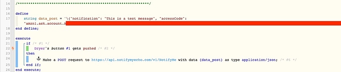

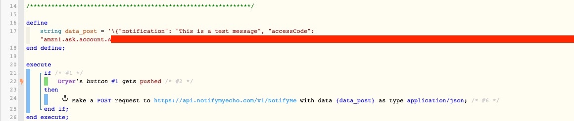

Just trying a simple piston to call the NotifyMe API on a simple trigger, in this case when the HomeSeer HS-FS100-L indicator light sensor sees the light go out (“Button #1”) on my dumb dryer. I’ve copied a sample piston from a single-post member, and no matter how I try to do it, it comes back as "unauthorized – even though curl from a SHell works properly with the same credentials. Note that I’m a rank newbie not just on the forum, but scripting as well. I’m reading all I can, and trying to wrack my addled AARP brain to rattle what’s left in there to learn logic and syntax. It’s new to me, but not so foreign that I can’t learn as I go. I appreciate any and all help and will mark solved for sure!
ETA: I should note I also defined the string as a constant and that had no bearing of course.
ETA 2: the error in the log is truncated here, but it reads " +190ms ║║Error executing external web request: groovyx.net.http.HttpResponseException: Unauthorized"
Trigger should action a Post call to the NotifyMe URI.
Nothing happens, see log below for the “unauthorized” line.

+73ms ║║Sending external web request to: api.notifymyecho.com/v1/NotifyMe
+191ms ║║Executed virtual command httpRequest (118ms)
+193ms ║╚Execution stage complete. (142ms)
+194ms ╚Event processed successfully (194ms)

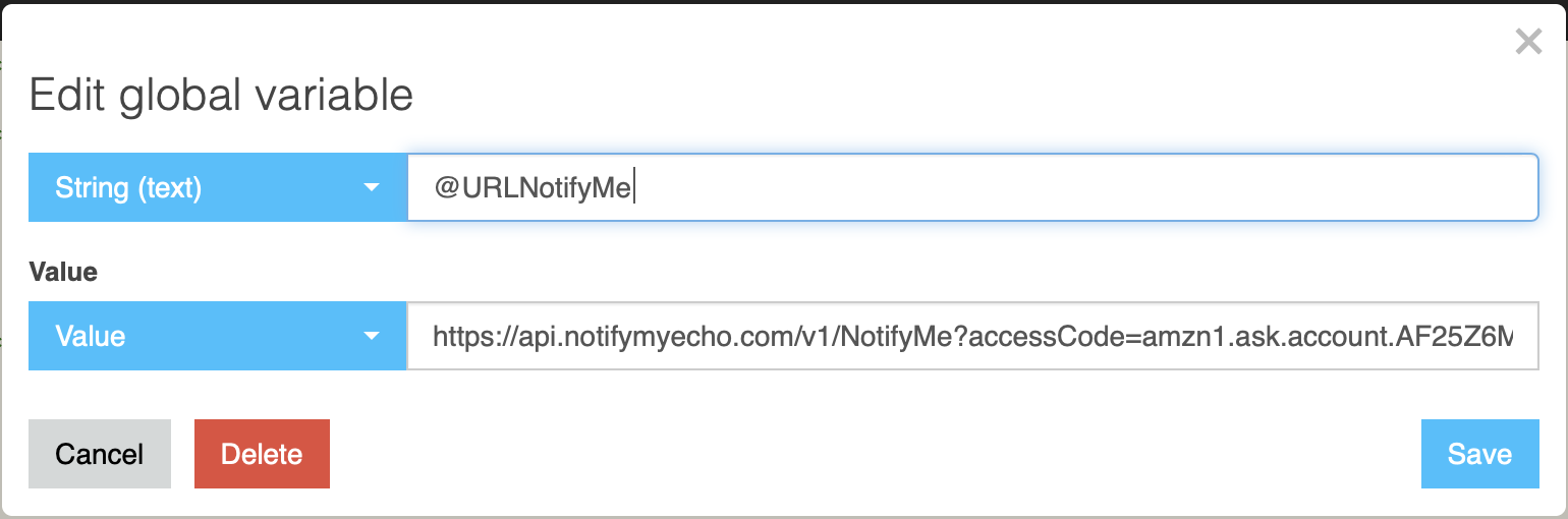

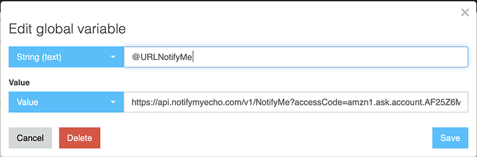

What I did was create a global variable like this:
The contents equate to:
@URLNotifyMe=https://api.notifymyecho.com/v1/NotifyMe?accessCode=<MY ACCESS CODE&notification=
Then from any piston I can use the following
String message=“My notify me message”
make GET request to {@URLNotifyMe message}
Just enter the two strings as an expression and you’re all set. No need to add any authorization or variables as it is all in the URL. Key is including the '&notification=" at the end of the URL string so all you need to do is append your message. Hope this helps.

I did not but I noticed that in the log as well. I double checked the global variable when I saw it and it’s correct. Not sure what that is.

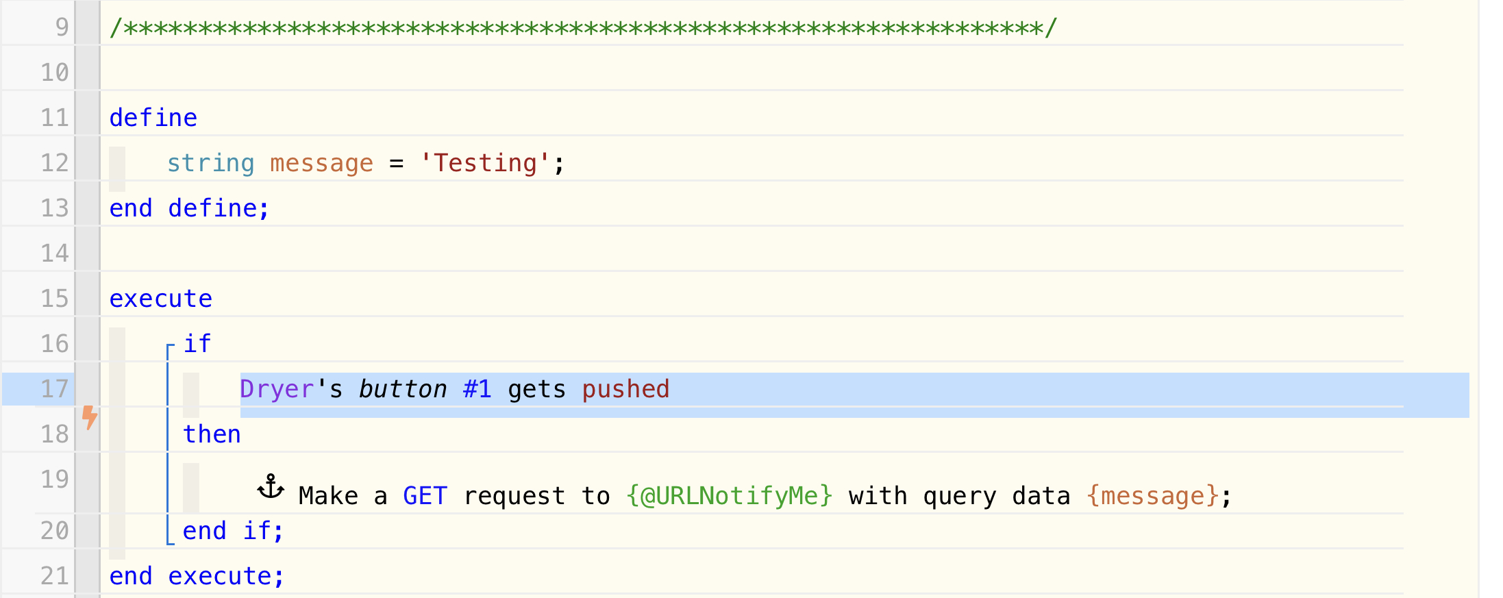

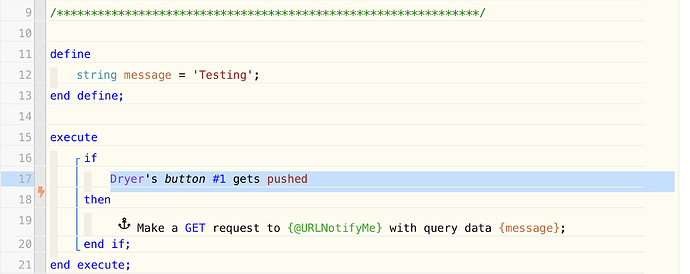

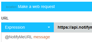

I would drop the “query data”, and try an expression, as @guxdude mentioned… IE:
pic
which ends up looking like this:
pic

OK! I did two things: first I copied the access code from the NotifyMe activation email again and dropped it in a proper text editor to make sure there isn’t a hidden line break; then, I modified the Get to dump the “message” string as you suggested. As you’ve already guessed, it worked! As you can see, I learn quickly: I knew that that hidden formatting error would get me and make the bug hunt drive me bonkers. :smiley:
